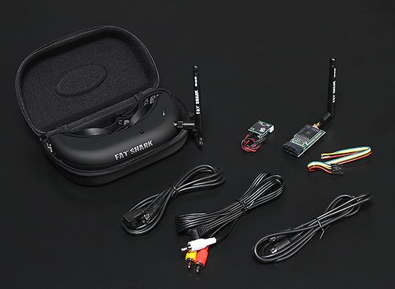

| 3 | ![]() | Fat Shark Teleporter V3 Kit with (PilotHD Camera) | 1 | HobbyKing 253000025-0 |

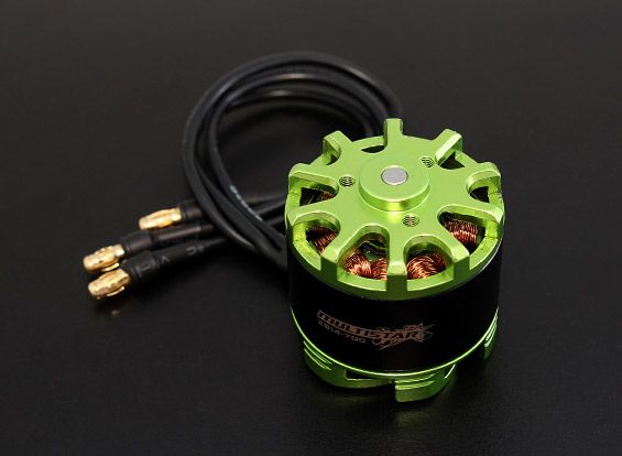

| 4 | ![]() | Turnigy Multistar Outrunner Motor | 4 | HobbyKing 9192000115-0 |

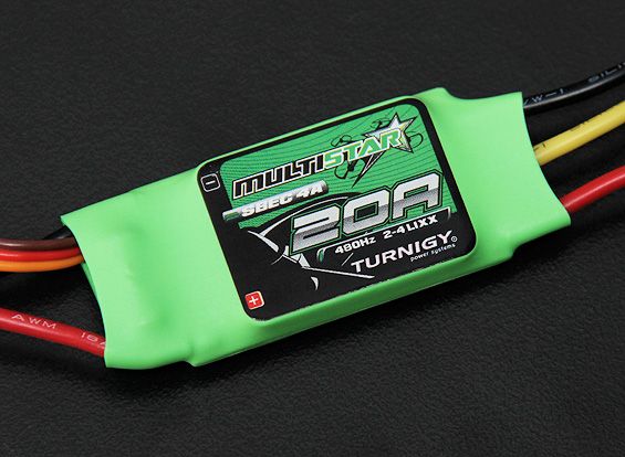

| 5 | ![]() | Turnigy Multistar 20A ESC | 4 | HobbyKing 9351000007 |

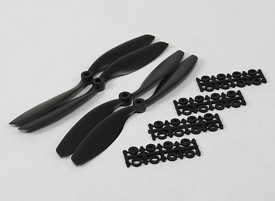

| 8 | ![]() | 8045 Propellers (set of four) | 1* | HobbyKing 017000058 |

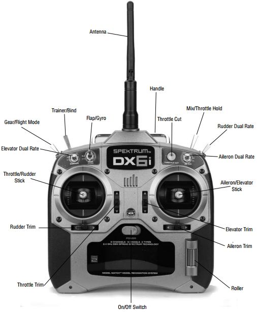

| 9 | ![]() | Spektrum DX6i 6-Channel Radio System | 1 | Amazon (transmitter only) |

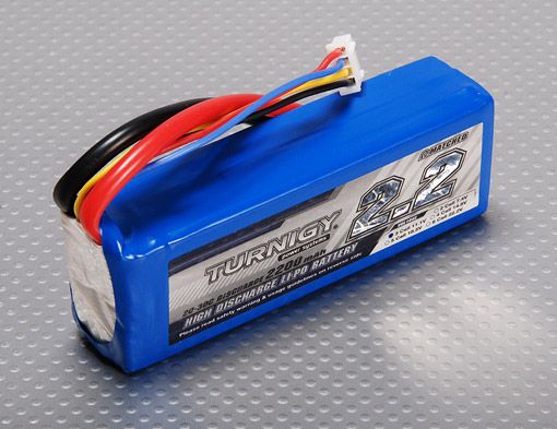

| 10 | ![]() | Turnigy 2200mAh LiPo Battery | 1* | HobbyKing T2200.3S.20 |

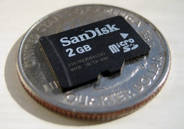

| 14 | ![]() | MicroSD Card | 1 | Amazon |

3 The Fat Shark Teleporter V3 is a goggle-style FPV receiver. There are basically two types of FPV viewers, screen types and goggle types. Screen viewers are just small (about 7-inch diagonal) LCD screens, typically mounted in some kind of sun shade, used for viewing the FPV feed. Goggle type viewers, like the Teleporter V3, go, as you can probably guess, on your eyes. I chose the goggle type because it is more immersive. The PilotHD camera that comes with the Teleporter V3 is fantastic for FPV. The PilotHD is like two cameras in one; it is used to capture the video feed, and it also records video. This means you will not have to use one camera for the FPV feed and a second for recording.
4 The Turnigy Multistar motors are high-quality motors designed specifically for use on multirotor aircraft.
5 These Turnigy ESCs (electronic speed controllers), like the motors, are designed specifically for multirotor aircraft. HobbyKing often runs out of stock on these ECSs so you might have to select a different ESC for your quadcopter build. Pretty much any ESC will work, as long as it is 20A or higher.

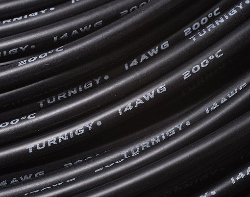

6,7 These small bullet connectors and wire will be used to make various connection cables for hooking up various components.
8 These are the propellers for the quadcopter. The only thing to mention here is that, although you will only need one set, you might want to order a few extra sets. In a crash, the propellers are always the first thing to break so, if you do crash, you don't want to wait weeks for a new set of propellers to ship from Hong Kong. It is even fairly easy to break propellers while transporting your quadcopter. Since they only cost a few dollars, I think it is worth ordering a few extra sets of propellers to have on hand.

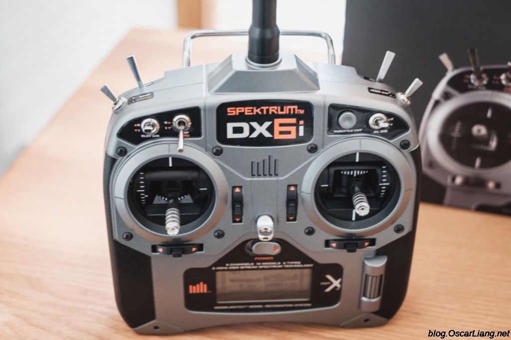

9 The DX6i is Spektrum's entry-level radio system. However, Spektrum is a top-quality brand in radio systems, and the DX6i is a great transmitter, especially for its low price ($~110). The DX6i is a 6-channel transmitter, which is sufficient for the Quanum Venture quadcopter. If you want to put a camera gimbal on your quadcopter at some point, you may want to upgrade to a 9-channel system, which will allow you to control the gimbal angles. The minimum requirement for the transmitter is that you must be able to adjust the end points of all the channels, especially the switches. This means you probably need a computerized transmitter. The DX6i also comes with a receiver which will be mounted inside the quadcopter.
10 This battery will power the quadcopter. Note that we also have a different battery for the Fat Shark goggles. You only need one battery for your quadcopter, but I actually like to have two so that I can swap them out in the field to extend my flight time. With a fully charged battery you should be able to fly anywhere from four to eight minutes, depending upon how aggressively you are flying; it is a bit like how a car's fuel economy depends on how aggressive the car is being driven.

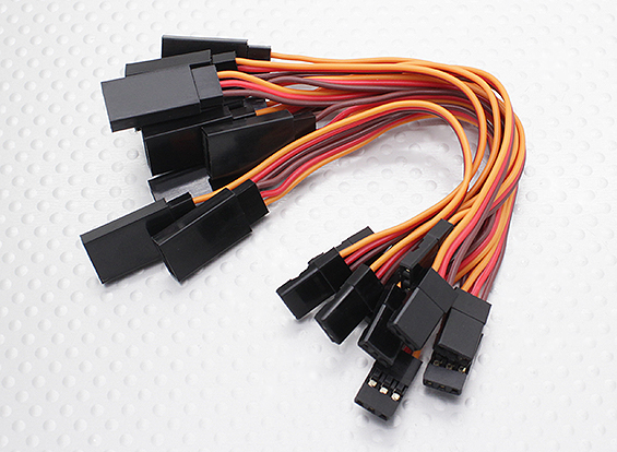

12 These servo cables are for attaching the radio receiver to the flight controller. The Naza M Lite does come with a pack of servo cables, however they are a bit too short to reach from the radio receiver mounting point to the flight controller.

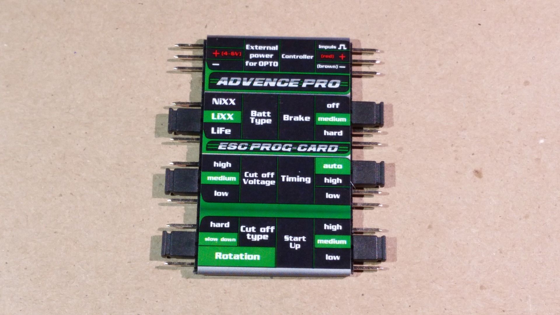

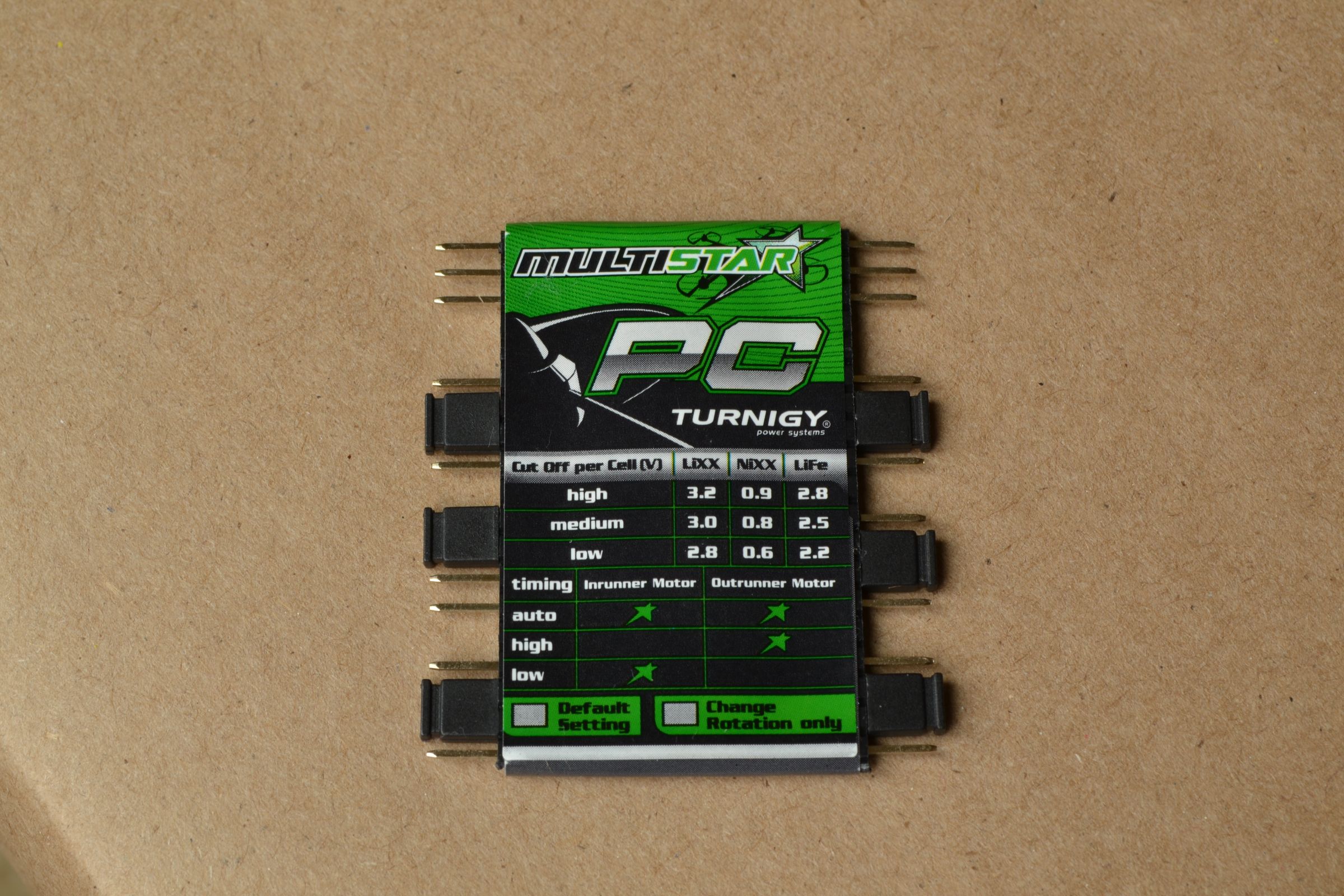

13 This simple device is used to program the ESCs.
14 The PilotHD uses a microSD card for recording but it does not include one. Just go for the cheapest, lowest cost SD card you can get. A 4GB card will give us about an hour of recording time, which is plenty since a battery charge is only good for teight minutes of flying at the most.

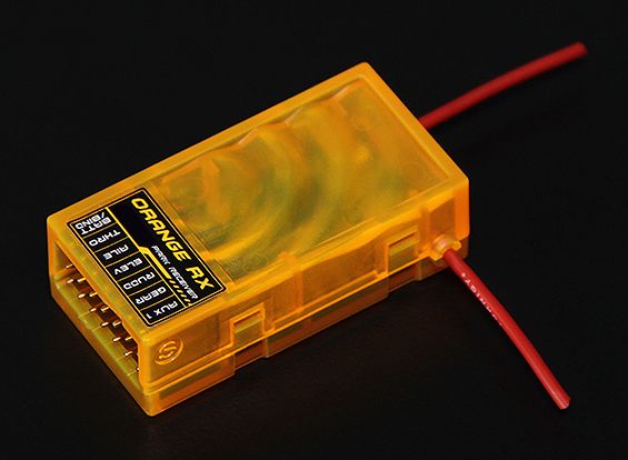

15 If you haven't been working with multirotors very long, you might not realize that there is a bit of an ongoing argument in multirotor circles about this OrangeRX (HobbyKing) brand of radio receivers and genuine Spektrum AR610 receivers. Pilots argue a lot about which of these receivers is better and about their relative merits. On one hand, Spektrum receivers are, obviously, built specifically to work with Spektrum transmitters and many people maintain that genuine Spektrum receivers are higher-quality than OrangeRX receivers. The OrangeRX R615X is basically a knockoff of Spektrum's AR610 receiver. Although they are actually less like knockoffs than they used to be as today's OrangeRX receivers use different hardware than the Spektrum receivers. Now, if you search online, you will find extensive information about pilots testing Spektrum receivers against OrangeRX receivers. Many people have an automatic mistrust of cheap third-party product clones, but from all of the information I can find, the performance of these two receivers seems very similar. Furthermore, in terms of range at least, the contention is irrelevant here because both Spektrum and OrangeRX radio systems will easily achieve a 0.75 mile range, but the range of the Fat Shark FPV system is only about half a mile. My choice to go with the OrangeRX R615X is motivated by one factor: the OrangeRX R615X costs about $7 and the Spektrum AR610 costs about $50.

In this step we will mount our four motors onto the motor mounts and then in the next step we'll mount the motors to the inner frame. We have four motors and four motor mounts so repeat the procedure below four times.
- Take a look at the motor mounts. You will notice a pointy bit on one side, this side is the bottom.
- Take one of your motors and route the three wires down through the top of the motor mount and out the side (this is where the motor mount will attach to the arm in the next step).
- Use four 3x8mm screws to attach the motor to the motor mount. It is particularly important to use thread locking compound here because the vibrations generated by the motor will quickly loosen the screws without the glue locking them in place.

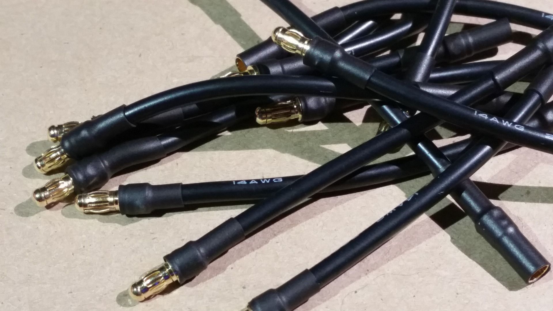

Step 4: Create Motor Cable Extensions
Before mounting the motors on the inner frame we need to create cables to extend the motor wires.
In the next step we will be attaching the motor mounts to the Quanum Venture inner frame. As part of that process we will route the motor cables down the arm tubes and out the square hole in the middle of the tube. Unfortunately though, most brushless motors do not have cables long enough to reach all the way down the arm. So, unless you purchased motors with extended cables, you will need to create some extension cables for your motors. The good news is, these are easy to make.
A few details before we begin though. First, as you probably already noticed, each motor has three wires. We will therefore need a total of twelve extensions. Second, the motor wires are terminated with 3.5mm bullet connectors. Third, these cables can carry pretty significant currents, for the motors I am using in this Instructable up to 12A. Therefore, make sure to use heavy enough wire gages, like 14 AWG.
- Cut twelve 4-inch pieces of 14 AWG wire.
- On each piece, solder one male bullet connector. There is a good video on soldering bullet connectors on YouTube. The technique illustrated in that video is the one I used and it works quite well.
- Before soldering the other bullet connector, slip two 1-inch long pieces of shrink tubing onto each wire.
- Onto the un-terminated end of each wire, solder a female bullet connector.
- Slip the shrink tubing over all the 24 bullet connectors. For the female connectors, slip the shrink tubing all the way to the end. For the male bullet connectors, slip the shrink tubing only to the end of the shank; you do not want to cover up the connector itself.
- Apply heat and shrink the tubing.
You can also go ahead and attach your cable extensions to all twelve motor cables.

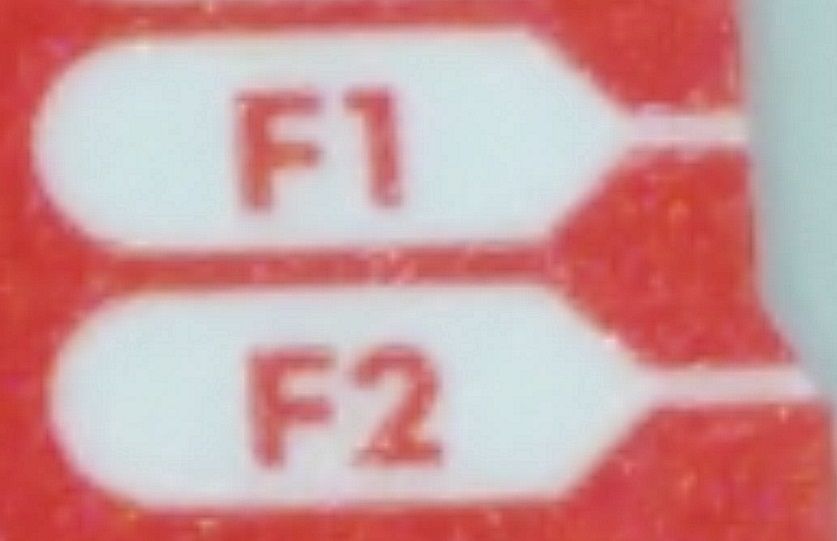

Step 8: Solder Ferrite Beads to the Power Distribution Board
In this step, we will start assembling the power distribution board by soldering on two ferrite beads.
At this point in the Quanum Venture quadcopter assembly process we are going to take a break from working on the inner frame and instead begin work on the power distribution board.
Assembling the power distribution board is probably the most difficult part of this entire project (with tuning as a close contender). There are quite few things to do and a number of steps where it would be easy to make a mistake. It also doesn't help that the Quanum Venture manual is pretty bad at documenting the assembly process.
So, the next five steps are going to cover attaching various pieces to the power distribution board. The most important detail in these steps is making sure you have the polarity of the parts correct or you could risk frying some parts of your quadcopter. Always remember red is positive and black is negative.
Solder Two Ferrite Beads onto the Power Distribution Board
Alright, let's get started. The first thing to do is solder the two ferrite beads to the power distribution board. Ferrite beads are passive components that help to suppress high-frequency noise in the electrical system. The motors on the quadcopter can generate significant electrical noise which can interfere with the sensors and other functionality of the flight controller, as well as cause interference in your FPV feed, so it is necessary to suppress this noise.
There is one more useful piece of information you should know before we start soldering parts to the power distribution board. Later on, we will be mounting the battery to the quadcopter. The battery gets strapped directly on top of the power distribution board. Because of this, many of the bulky components on the power distribution board will be soldered onto the bottom of the board so that room is left on the top for the battery. So, it is important to mount parts on the correct side of the board.
As pointed out above, when assembling the power distribution board, observing correct polarity will be very important. However, the ferrite beads actually are not polarized, so their orientation doesn't matter.
- Take a look at the power distribution board. It is a bit tricky to tell the top of the board from the bottom, but the easiest way right now is to look for the "Hextronik Ltd." label in one corner. The side of the board with the label is the top. We will be soldering the ferrite beads to the bottom of the board so flip the board over to the side without the "Hextronik Ltd." label.
- In the center of the board, on one side, you will find two pairs of holes where the through-hole ferrite beads will be connected (see pictures). The two beads mount right next to each other.
- Bend the ferrite bead wires 90 degrees and insert the wires through the holes in the power distribution board.
- I like to clip off the leads before soldering so I don't risk breaking the solder connection by clipping them later. So, clip off the protruding wires, leaving just enough left to form the solder connection.
- Solder the two ferrite beads to the power distribution board.

Create Power Adapter Connection Cables
The Power Module connection cables are just short lengths of wire with a female 3.5mm bullet connector on one side. We will need two connectors, one red, one black, for the Power Module.
- Cut one1-inch piece of red 14 AWG wire and one 1-inch piece of black wire.
- Strip about 1/8 inch of insulation from each end of each wire.
- Onto each wire, solder a female 3.5mm bullet connector like we did before.

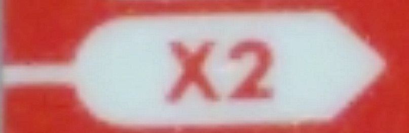

Step 13: Solder ESC Connectors to the Power Distribution Board
Like we did for the Power Module, we will create cables for connecting the ESCs to the power distribution board.
Now here is a point where I am going to deviate quite a bit from the official Quanum Venture manual. We will need to connect our four ESCs to the power distribution board. The manual suggests that you clip the ESC wires and solder them directly to the power distribution board. I think this is a bad idea though. If you solder your ESC's directly to the power distribution board, it will be difficult to replace them if they break or if you want to upgrade your electronics.
So, what we are going to do instead is make some ESC connection cables similar to the flight controller power source connectors we made in the last step, solder those connection cables to the power distribution board, and connect the ESCs through the connection cables. This way, if we ever need to replace an ESC for any reason, we can just unplug and old ESC and plug in the new one. We can avoid having to desolder things and risk damaging the board.
Alright, lets get started with making some ESC connection cables.
Create ESC Connection Cables
Alright, so the first thing we need to do is create some ESC connection cables, which are just short lengths of wire with a female 3.5mm bullet connector on one side. We will need a total of eight ESC connection cables, two for each ESC.
Polarity will again be important for connecting our ESCs, so cut four 1-inch lengths of red 14 AWG wire and four 1-inch sections of black wire. Strip about 1/8 inch of insulation from each end of each wire. Onto each wire, solder a female 3.5mm bullet connector like we did before.
Solder the ESC Connection Cables to the Power Distribution Board
Now we can solder are ESC connection cables to the power distribution board.
Take a look at the power distribution board. On the bottom of the board, where we will be soldering the ESC connection cables, you will find eight solder pads in sets of two. Like with the other wires though, the polarity labeling is on the top of the board. We will solder the connection cables so that they point towards the closest end of the board. Eventually the ESC cables will wrap around the outside edges of the board to connect. So, start by soldering on the four red connection cables to the four positive solder pads. Do this on the bottom of the board. Now solder the four black connection cables to the four negative pads.
Plug in the ESCs
Now we can finally attach the ESCs to the power distribution board. This is easy. For each of the four ESCs, just plug the ESC's red wire into the red connector cable and the black wire into the black connector cable. Then, use two zip-ties, one on each end of each ESC, to fasten the ESCs to the power distribution board.

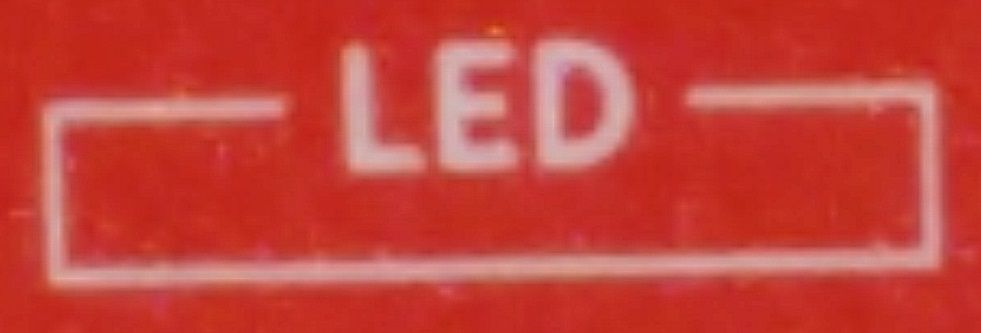

Step 18: Install DJI LED Indicator
With the mounting bracket in place we can now install the LED indicator.
At this point in the quadcopter build process we are going to start installing all of the electronics. We have a bunch of different devices to install and I think it is easiest to install everything and then wire everything up. Otherwise we will end up with a big spaghetti mess to stuff into the quadcopter. We will be installing the following devices, in order, over the next six steps:
- DJI LED Indicator Radio receiver
- DJI Power Module
- FPV video transmitter
- FPV camera
- DJI GPS/Compass module
And then we will get to the flight controller later on.
The first device we will install is the DJI LED indicator. Before we mount this device to the quadcopter though, I want to take a moment to explain what it does because it is actually a pretty nifty tool.
About the LED Indicator
The LED indicator has a tri-color, high-power LED used to communicate all kinds of information to the pilot during flight and also during hardware setup and programming. The LED lights up to display different information. For example, the LED flashes "red, red, red, green" when fewer than five GPS satellites have been acquired and holds solid green when more than six GPS satellites have been acquired. The LED flashes rapidly red when the battery gets low. The LED can also flash yellow and can deliver many signals besides these examples.
The LED module also has a USB interface which we will use later on to connect the flight controller to a computer for programming, firmware updates, calibration, and so on.
The LED indicator mounts to the metal bracket underneath the power distribution board, which we installed in the previous step. The LED mounting bracket is not symmetrical. One side of the bracket is longer than the other side. This is because the specific position where we will mount the LED indicator has two important considerations.
First, there is a hole in the bottom part of the Quanum Venture shell, which we will install a little while later. We have to position the LED indicator such that its light can shine through the hole. The bottom of the quadcopter’s shell also has a hole where we can plug a USB cable into the port on the LED indicator without disassembling the craft. It is this kind of attention to detail that makes me such a fan of the Quanum Venture frame.
A Comment About Foam Tape
We will mount the LED indicator onto the metal angled bracket we installed earlier. Now, you could use a piece of 3M foam tape (included in the kit) to attach the LED indicator on the metal bracket and that would be fine; but I just don't like using foam tape to fasten parts on the quadcopter. I think using foam tape makes maintenance a pain since it is difficult to detach components without damaging them. Plus, even if you manage to get the foam tape to release, you will be left with a sticky mess.
I think 3M Command Strips are a much better option for easily attaching parts on your quadcopter. Command strips can be much more easily removed in case you need to perform maintenance on or wish to upgrade any of your equipment. I also usually reinforce the Command Strip connection with zip-ties for added strength on larger parts.
Install the LED Indicator
So that is how we will fasten the LED indicator to the mounting bracket, with a 3M Command Strip.
- Remove the paper backing from one side of a small 3M Command Strip.
- Stick the Command Strip to the mounting bracket.
- Remove the paper backing from the exposed side of the Command Strip. Stick the LED indicator to the Command Strip. The side of the LED indicator with the cable wires should face the shorter side of the mounting bracket and the USB side should be flush with the end of the mounting bracket. Also, the LED should obviously face upward.
- Apply firm pressure for 30 seconds.

- Locate the microSD card slot on the top of the PilotHD. With this side facing up, stick the camera into the bottom of the camera holder.
- Now place the other non-sticky piece of foam into the upper-front corner of the top part of the camera holder, so it mirrors the piece you put in the bottom.

Now that you understand all the connections on the flight controller, direct your attention to the radio receiver. Each channel on the receiver corresponds to a different action on the radio transmitter. For example, the RUDD channel receives commands when you move the right stick left and right, the THRD receives commands when you move the right stick up and down, etc.
Each of the three pins for each channel carries a different electrical connection. The OrangeRX R615X receiver does not come with any documentation (thanks HobbyKing), so it took me a bit of search to figure out which pins make which connections, signal, positive, and negative. It turns out, on the side of the receiver, molded into the plastic so it is difficult to see, there is a little S icon that reveals that the row of pins closest to the label is signal. So, the pin layout goes like this:
- Signal (yellow/orange wire) is the row closest to the label
- Positive (red wire) is in the middle
- Negative (black wire) is on the bottom, farthest from the label

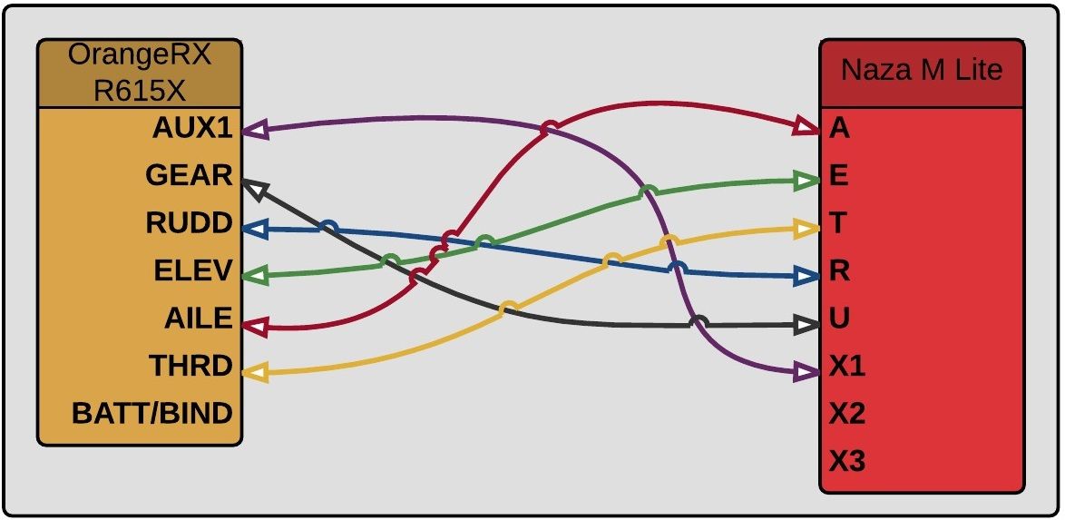

Connect Radio Receiver to Flight Controller
If you take a look at the labels on the radio receiver and the flight controller, you will notice that each device uses different characters to identify the channels. The table and image below will help you match up the channels.
| Receiver Image | Receiver Connection | Naza M Lite Connection | Naza M Lite Image |
![]() | AUX1 (gimbal pitch control) | X1 (gimbal pitch control) | ![]() |
![]() | GEAR (flight mode) | U (flight mode) | ![]() |
![]() | RUDD (rudder) | R (rudder) | ![]() |
![]() | ELEV (elevator) | E (elevator) | ![]() |
![]() | AILE (aileron) | A (aileron) | ![]() |
![]() | THRD (throttle) | T (throttle) | ![]() |
Connection Image
Now that we can identify all of the connections on the Naza M Lite and on the radio receiver, we are ready to make the connections between the flight controller and the radio receiver. This is easy to do. I would advice making connections one at a time, otherwise you will have a bunch of wires sticking out of the radio receiver and it will be easy to get confused.
I started with the connection between the AILE channel on the radio receiver and the A channel on the flight controller. First, simply insert the three-wire jumper into the radio receiver AILE column with the signal wire (yellow) closest to the label. Then, insert the other end of the wire into the flight controller A column with the signal wire (yellow) farthest from the label.
Just repeat this procedure for all the connections according to the table and image above.

If you look at the label on top of the Naza M Lite, you will notice a box labeled "LED". This, as you might expect, marks the spot where the LED indicator connects.
Unlike the radio receiver connections, the LED indicator connection goes horizontally across pins. On the side of the Naza M Lite there is a spot across the top of the radio receiver connections where you should plug in the LED indicator cable. The plug will only fit one way so you shouldn't be able to connect it the wrong way.

Next up we are going to start working on the ESCs. We need to program them and connect them to the flight controller. Before we do anything else though we need to connect the ESCs to the motors.
About Motor-ESC Connections
The ESCs have six different cables coming out of them. We've already used two of the cables to connect the ESC to the power distribution board. In the next step we will use the three-pin connector cables to hook up the ESCs to the flight controller. So that leaves us with three cables. These three cables will attach to the three cables on the motors corresponding to each ESC.
Now, the order in which we attach these cables is important. The order determines in which direction the motors will spin. Here's the catch though, until we finish hooking up all the electrical components, plug in the battery, and manually check the motor spin directions, we will have no way of knowing whether we've plugged the the three wires in the correct order or not.
So for now we will just hook up all the motors to their corresponding ESCs in a random order. Later on, when we test the motor spin directions, if we find that a motor is spinning in the wrong direction, we can easily reverse the direction by switching any two of the motor-ESC connections.
Connect the Motors to the ESCs
Let's start connecting the motors to the ESCs. Way back when we attached the motors to the inner frame we labeled the wires coming out of the frame arms to identify each motor. Here's a refresher: the front-right motor is Motor 1, the front-left is Motor 2, the back-left motor is Motor 3, and the back-right motor is Motor 4.
The ESC on each corner of the power distribution board corresponds to the motor on the same corner of the inner frame So, for example, the front-right ESC connects to the front-right motor, which is Motor 1.
Connecting the ESCs to the motors could not be easier. Simply plug the three wires from the motors, coming out of the inner frame arms, into the three wires on the corresponding ESC. Do this for all four motors.

Adjusting Settings on the ESC Programming Card
If you look at the sides of the ESC Programming Card you will notice a bunch of pins and six 2-pin jumpers. The ESC Programming Card has a label on each side, on one side is information about cut off voltages for different battery chemistries and recommended settings for different types of motor. The other side is where the important information is found.The label shows which pins correspond to the six different settings described above. There are six 2-pin jumpers that correspond to the six settings. By moving the jumpers so that they bridge different sets of pins, you can change the settings on the ESC Programming Card. Move the jumpers around so that the settings are configured as follows (also check out the picture):
Batt Type = LiXX
Cut off Voltage = medium
Cut off type = slow down
Brake = off
Timing = auto
Start Up = medium
Programming the ESCs
Alright, let's actually program the ESCs. We will need to program each ESC individually so just repeat the procedure below for each ESC.
The first thing we need to do is plug the Power Module into the power distribution board so it can receive power from the battery. Simply connect the red wire from the Power Module to the red connection wr soldered onto the power distribution board. Then connect the black wire as well.On the side of the ESC Programming Card with all the settings listed, in the upper-right corner you will find a set of three connection pins labeled, "Controller." This is where you will plug in the ESC with the yellow wire on the input in and the brown wire on the - pin.In the upper-left corner of the ESC Programming Card, opposite the ESC connection, plug in the output cable from the Power Module as shown on the label. The grey wire is negative and the res wire is positive. Now we just need to apply power to the system to program the ESCs. So simply plug the battery into the XT60 connector. Note that even if you have no charged the battery it should still have plenty of power. LiPo batteries are stored and shipped partially charged because this extends their shelf life.
When you plug in the battery, you should hear two beeps which indicates that the ESC has been successfully programmed. If you hear only one beep and then the ESC keeps beeping (technically it is the motors that make the beeping noise by the way), disconnect the power, switch any two of the motor leads, reconnect the power, and try the programming procedure again.

Step 35: Set the Model in the Spektrum DX6i
Setting up our model in the DX6i will allows us to save our settings profile in case we ever want to control a different vehicle.
The DX6i has a useful feature called ModelMatch. The DX6i can be programmed with up to ten different models; in other words, the DX6i can store settings for up to ten vehicles. This is a great feature if you are operating different vehicles because you can load individualized settings for each craft with the push of a button. This way you don't need to reprogram the transmitter every time you change vehicles.
For example, I use my DX6i to control my Quanum Venture obviously. I am also working on a robot (which I hope to post an Instructable about soon) that I control with the DX6i. I can easily switch between these two machines on the DX6i in order to load the different setting.
The ModelMatch feature allows the radio receiver to recognize which model you have selected on the transmitter and prevent you from accidentally using the wrong settings for whatever craft you are using. For example, the radio system will not let me try to fly my Quanum Venture with the transmitter set to control my robot.
Using this feature has two broad steps: set the model in the transmitter, and rebind the radio system. Before we do the first part, setting a model in the transmitter, we will take just a moment to learn how to navigate the settings in the DX6i.
Navigating the Spektrum DX6i
Navigating the DX6i is easy. On the right side of the screen you will find a cylindrical button/wheel control. This control has two modes of operation. First, you can click the wheel to make selections. Second, you can scroll the wheel in either direction to move through menus and alter values.
Alright, now let's get started setting our model in the DX6i.
Set the Model in the DX6i
You can think of models on the DX6i almost like folders. The models have a name and they contain all the settings for your craft. We will get to the settings a few steps in the future; for now we need to give our model a name in the DX6i.
When you first turn on the transmitter you will be looking at the main screen, which displays some basic information about the transmitter. On the left side there is a little meter that can let you know when the batteries are getting low on power. The most useful information found on the home screen though doesn't appear for us yet. The home screen displays the selected model, but we haven't named our model yet so for now it displays nothing. Click the navigation wheel to enter the DX6i's menu.
We will be doing a lot of work in this menu before we are ready to fly. For now, scroll all the way to the bottom and select SETUP LIST. This will take you into another menu. From the setup list menu, select the second item, MODEL NAME.
First of all prepare yourself for a ton of little beeps from your transmitter and use the scroll wheel to name your model. You can use any name you want, whatever will help you recognize which model name corresponds to your Quanum Venture. I named my model Venture. When you are done inputting the model name select Ok! On the right side of the screen.
Now go back to the main menu by selecting List in the upper-right corner of the screen and then selecting Main from the upper-right corner of the next screen.

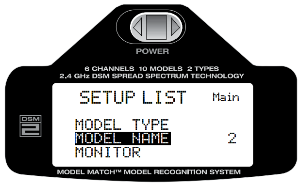

DX6i Screen Simulations
To make it easier to see the options on the screen, I created these illustrations to simulate the display. Follow this screen order to set the name of your model:
- From the main menu, select SETUP LIST
- From the setup list menu select MODEL NAME
- Input a model name
- Your model name will appear on the home page
Rebind the Radio System
Now that you’ve set and selected a new model in the Spektrum DX6i that will hold our settings for the Quanum Venture quadcopter, you will actually need to bind the radio system again. This is a little bit annoying, but it will activate a useful feature, ModelMatch. When we bound the radio system the first time, we were teaching the radio receiver to recognize the unique identification code of our transmitter. This time we will also be teaching the radio receiver to recognize which model is currently selected on our transmitter. This way, the radio receiver will not follow directions if we have the wrong model selected. This is a nice safety feature.
So, you will need to repeat the binding procedure detailed in the previous step before advancing to the next step. Remember to turn off your radio transmitter for the binding process.

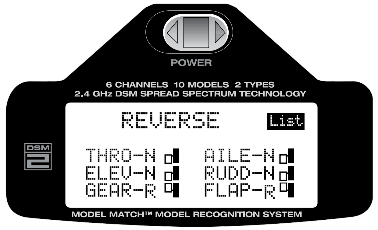

Step 46: Reverse the GEAR Switch Direction
In this step we will reverse the direction of the GEAR switch, used to select flight modes.
At the end of the previous step, we made sure all of the sticks were traveling in the directions we wanted. There is one more control though that we will need to reverse, the GEAR switch. The next step, which is the longest in this entire Instructable, will discuss the functions of the GEAR switch in great detail, but before we get to that step, we need to change the direction of the switch. The GEAR switch is used to select flight modes for the Naza M Lite, and it has to be reversed in order to work properly.
Unlike the control sticks, however, there is no option in the DJI Assistant software to reverse the direction of the switch. Therefore, we will need to use the settings in the radio transmitter.
- From the DX6i main menu, select the last item in the menu, SETUP LIST
- Scroll down and select REVERSE
- This screen allows us to reverse the directions of any of the controls, We want to reverse the direction of the GEAR switch, so scroll down to the GEAR option and change the option to R.

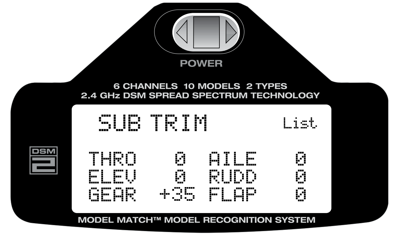

We will do this using the Travel Adjust function. The travel adjust feature allows us to change the range between the maximum and minimum values of a control. That is exactly what we want to do here! To begin with, make sure to flip your GEAR switch to the down (0) position. Now, it takes a bit of experimentation to figure out workable numbers, but in the transmitter's TRAVEL ADJ screen, reduce the GEAR setting to 80%. Now go back into the DJI Assistant software and try flipping the GEAR switch back and forth again.
You will notice that the chevron doesn't move so far this time. In fact, it travels 20% less distance than it did before. It almost looks like the distance between the maximum and minimum values matches the distance between the GPS area and the Atti. area, right? But we have another problem, the chevron should now be flipping between the two failsafe areas. What we need to do now is just move the entire range over so it matches up with the GPS and Atti. areas. Well we will use another feature to accomplish this, the Sub Trim feature.
Sub trim is basically used to literally trim the off the bottom of the control range, or it can be used to add some to the bottom of the control range. You can think of the Sub Tim feature as a way to move the entire range of control inputs up or down. Imagine that, this is exactly what we want to do again! So, the second step in making the flight mode selection work is reducing the sub trim level of the GEAR switch.
So go in to the DX6i menu again and select SUB TRIM. We are interested in adjusting the sub trim for the GEAR switch. Again, the proper setting are determined by experimentation, but here you can easily see how we figure out what values to use. Keep your eyes on the DJI Assistant software while you decrease the sub trim level for the GEAR switch (we are reducing the value because we want the entire control range to move left). You should notice the chevron moving to the left! If you flip the switch you will notice that both ends of the control range are moving. Set the sub trim level to ↓ 35.
Now if you flip the GEAR switch, the chevron should switch between the GPS and Atti. positions. Congratulations, you've just manged to do what many, many pilots have great difficult accomplishing.

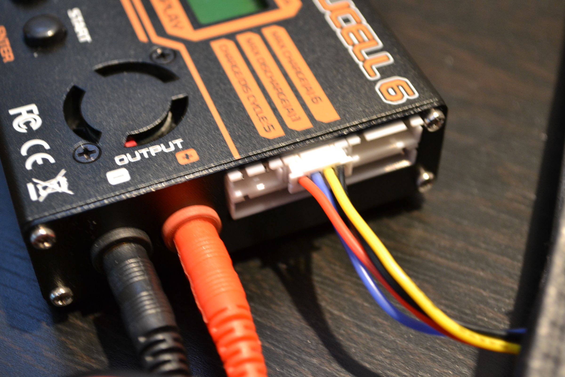

The first step is to connect your battery to the charger. So, remove your battery from the quadcopter frame by undoing the Velcro strap and then lifting the battery off the Velcro strip. You should always remove your battery from your quadcopter before charging it; just in case something crazy happens, like the battery catches fire, you defiantly do not want your entire quadcopter to go with it. Take a look at your battery and you will notice that there are two sets of wires coming out one end: the thick red/black set that we use to connect the battery to the quadcopter, and a set of four thinner colored wires with a thin plug at the end. We will plug both sets of wires into the Accucel-6 charger.
First, included with the charger were several wire adapters with red and black plugs on one end, and a variety of connectors on the other end. Locate the adapter with an XT60 plug on the end, this is the plug that matches the yellow plug on the battery. Next, on the right side of the Accucel-6, you will notice a red port and a black port. Connect the red and black plugs on the battery adapter into the matching colored ports on the Accucel-6. Now plug the XT60 plugs on the battery and on the battery adapter together.
Now let’s plug in the set of colored wires from the battery.Take a look at the right side of the Accucel-6 again and you will notice a bank of white female connectors with pins in them. Notice that each connector has a different number of pins. Now shift your attention to the group of four colored wires from the battery, notice that the connector at the end has four male pins. You can probably guess what we’ll do next. Connect the white battery plug to the slot on the Accucel-6 that has four pins. Just FYI, this little plug is extremely important. This is the balance plug and it gives the battery charger information about the relative charging rates and total charge of the battery's three cells. It is of utmost importance that the three cells in the battery are charged at the same rate and to the same capacity. An unbalanced LiPo battery is very dangerous because it can start on fire as one or more of the cells becomes over discharged. The balance plug will ensure this doesn't happen.
Program Charger
With the battery connected to the Accucel-6 charger, we now need to set up the charger to use the correct settings for charging our battery. Before we begin this process, I want to make a very important safety note: it is absolutely imperative that you use the correct settings for charging your battery. Failure to charge the battery with the correct settings could result in damage to the battery, the charger, or even catastrophic failure of the battery which could result in a fire/explosion. Also, during charging, always put your battery in a LiPo bag, which is a fire-proof bag designed to contain any battery failure. You should also never leave a battery unattended while it is charging.
I certainly do not wish to scare you with this information, but lithium polymer batteries are capable of high discharge rates and are made with some pretty volatile ingredients, like lithium, and it is important to be safe. In reality, if you handle, charge, and discharge the batteries with some care, you will be just fine. LiPo batteries almost never fail the way you see in some videos on YouTube. So with the safety information out of the way, lets get started setting up the Accucel-6 to charge our battery. First, we will need to gather some information about the battery, which should be printed on the battery’s label, otherwise you can obtain information from the manufacturer’s documentation. The information we will need is: the number of cells in the battery, the voltage of the battery, and the maximum charge current of the battery. For the Turnigy 2200mAh 3S 20C Lipo Pack used in the Quanum Venture quadcopter tutorial, the information we will need is as follows:
Number of cells: 3
Voltage: 11.1V
Maximum charge current: 2.2 Amps
The first two pieces of information here, the number of cells and the voltage of the battery are easy to find, they are written right on the battery label. The third bit of information, the maximum charge rate, requires a little bit of math to figure out though, which I will take a moment to explain.
First of all, calculating the maximum charging current requires two other pieces of information: the battery’s capacity, and the maximum charging rate of the battery. The battery’s capacity is written right on the battery label. The battery’s capacity is expressed in units of milliamp hours (mAh), which basically describes how much power a battery can supply for how long. The capacity of the battery used in the Quanum Venture quadcopter tutorial is 2200mAh. As for the maximum charge rate for the battery, the maximum safe charge rate for our LiPo battery is 1C. Here, the C stands for Coulombs, which is basically a unit of electrical charge. This is probably a slower rate that you could technically pump into the battery, but we want to make absolutely certain that the battery does not start on fire, so we will go with the safe rate of 1C.
From the battery’s capacity, and the maximum charge rate of 1C, we can calculate the maximum charging current of our battery. First of all though, charging current is expressed in units of Amps. To find the maximum charging current for our battery, we will multiply the battery’s capacity in amp-hours by the maximum charging rate in coulombs. First, move the decimal point in the 2200mAh capacity listed on the battery label three spots to the left to convert from milliamp hours to amp hours. We end up with 2.2Ah. So, multiplying this figure by the maximum charging capacity of 1C, we end up with a maximum charging current of 2.2A.
So now that we did all that work and all that math (it wasn't too bad actually), I am going to tell you that, unless you are in a big hurry, you should probably not charge the battery at the full 2.2A charging current. It will prolong the life of the battery if you charge at a lower rate. So in this tutorial we will use a charging current of 1A.
Now let’s finally get to programming the Accucel-6. First of all, plug in your 12V power adapter to the plug on the left side of the Accucel-6. As soon as you connect the power, the Accucel-6 will emit a loud beep. You should get used to these extremely loud beeps as the charger will be deeping a lot in the next few minutes. After the Turnigy splash screen goes away, you will be presented with a screen with “PROGRAM SELECT” in the first line and a battery type in the second line. If the battery type listed in the second line is anything but “LiPo BATT,” press the leftmost “Type” button to change the battery type. Once you have “LiPo BATT” in the second line, press the right-most “Enter” button.
On the next screen, the first line lists what action the Accucel-6 is taking. The device is capable of charging the battery, balancing the battery, fast-charging the battery, storing the battery, and discharging the battery. These functions are all useful and some are covered in other tutorials around the Internet, but for now, use the middle two arrow buttons to select “LiPo CHARGE” since we are interested in charging the battery right now.
The second line lists settings for the charging process, from left to right the settings are:
charging current
battery voltage
(battery cell count)
To change these settings, press the Enter button. The charging current setting should now be flashing. Use the arrow buttons to set the charging current to 1.0A. Now press the Enter button again to select the battery voltage/cell count setting. Use the arrow buttons again until “11.1V(3S)” is selected.
With the correct settings applied, we are finally ready to charge the battery.
Charge the Battery
To start the charging process, hold the Enter button for three seconds. The Accucel-6 will beep a few times and then it will check the battery. After a couple seconds, a you will be presented with a new screen. The first line lists the settings you entered on the right, and the settings detected by the Accucel-6 on the left. If these settings do not match, press the leftmost “Back” button to return to the previous screen and double-check your settings. Otherwise, if the settings on the top line to match, press the Enter button to start charging.
The Accucel-6 will display the status of the charging progress. It lists the battery type and cell count, the current charging current, the current battery voltage, the charging time, and the battery capacity. Now you just need to wait for the battery to finish charging. Remember never to leave the battery unattended while charging. If you have to leave before the charging process is complete, stop the process by pressing the left-most “Stop” button. Lithium polymer batteries do not have a “memory effect” so you can always finish charging the battery at a later time.
When the battery is done charging, the Accucel-6 will start beeping. First press the Stop button, and then disconnect the battery from the charger. Now you are ready to fly some more.

Adjust DX6i Settings to Select Manual Mode
If you followed the procedure in Step 47 to calibrate the DX6i flight mode switches, you will not be able to put the Naza M Lite into Manual mode. While we are flying this is a good thing; with a relatively large and heavy quadcopter like the Quanum Venture, putting the flight controller into manual mode would almost certainly result in a crash. However, as we will see shortly, we need the ability to select both GPS Atti. mode and Manual mode in order to put the Naza M Lite into compass calibration mode.
Here's what we will do; we will temporarily change the Travel Adjust settings on the DX6i transmitter to allow the GEAR switch to be used to select GPS Atti. mode and Manual mode. To do this we will follow a procedure similar to the one covered in Step 47. To begin, turn on your DX6i transmitter, connect the Quanum Venture battery, and plug the USB cable from your computer into the port on the LED indicator module. Then, open the DJI Assistant software.
In the DJI Assistant software, open Basic > RC. If you flip the GEAR switch back and forth, you should see the Control Mode Switch chevron switch between the GPS and Atti. positions. Set the GEAR switch in the upper position to select Atti. mode.
We want to move the chevron up to the Manual position. In the DX6i, open the main menu and select Travel Adjust. On the TRAVEL ADJ screen, the GEAR option should be set to 0%. Adjust that setting up to about 80%. While you increase this setting, you should see the GEAR chevron move upward, towards the Manual mode area.
When you are done, back out of the DX6i settings and go back to the home screen. Try flipping the GEAR switch back and forth; you should now be able to select either GPS or Manual mode. Now we will be able to put the Naza M Lite into compass calibration mode, so let's move on.

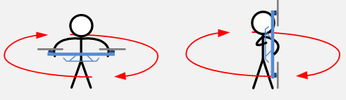

Calibrate the Compass
The compass calibration process involves rotating your quadcopter in two different directions. People often refer to this as the "compass dance," or the "Naza dance," or "dancing the Naza."
Compass Horizontal Calibration
First we will calibrate the compass for horizontal (yaw) rotation. With the Naza M Lite in compass calibration mode, denoted by a solid yellow LED indicator, pick up your quadcopter and rotate it slowly about the yaw axis. Try to keep the quadcopter as level as possible and rotate the quadcopter at an even speed. When you complete a full 360° rotation, the LED indicator will turn green.
Compass Vertical Calibration
Next we will calibrate the compass with the quadcopter positioned vertically. Lift up the quadcopter to a vertical position. Then, slowly rotate the quadcopter through 360°. When you complete the rotation the Naza M Lite will automatically exit compass calibration mode and return to the mode selected by the GEAR switch. The LED indicator will return to its normal function.
Fix DX6i Travel Adjust Settings
Don't forget to revert the DX6i Travel Adjust setting back to their previous values. Follow the same procedure used above, making sure the GEAR switch is in the up (1) position, to reset the Travel Adjust for GEAR to 0%.
Flip the GEAR switch to verify you can again select GPS Atti. and Atti. mode.
