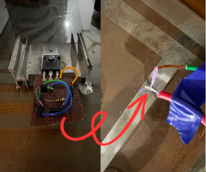

Ever wanted to generate jaw-dropping high voltage arcs at home? In this project, I’ll walk you through how I built a DIY high voltage flyback driver that outputs around 25,000 volts, using common components like the IRFP250N MOSFET, a 2N2222 transistor, and a homemade frequency generator I built earlier and shared on Instructables.
We’ll go deep into how this circuit works, why I made certain design choices, and how you can improve it. Expect flying sparks, a lot of learning, and yes — a solid 2.5 cm arc.

Step 3: Circuit Diagram
Frequency Generator to Gate Driver:
  1. Frequency Generator Output Pin (3.3V square wave) ---> 1kΩ resistor ---> Base of 2N2222 transistor
  2. use 8000hz for best result
2N2222 Transistor:
  1. Emitter (Pin 1) ---> GND
  2. Base (Pin 2) ---> From 1kΩ resistor connected to frequency generator output
  3. Collector (Pin 3) ---> One end of a 100Ω resistor ---> IRFP250N Gate (Pin 1)
Also:
  1. Connect a 10kΩ resistor from IRFP250N Gate (Pin 1) to +12V (this ensures full high logic)
IRFP250N MOSFET:
  1. Gate (Pin 1) ---> From collector of 2N2222 (through 100Ω resistor)
  2. Source (Pin 3) ---> GND
  3. Drain (Pin 2) ---> One end of the 7-turn primary coil
Primary Coil:
  1. Other end of the primary coil ---> +12V from power supply i used a 12v 2amps transformer and rectified it to DC
Flyback Transformer:
  1. Use your own 7-turn coil wound on the core as the primary (ignore built-in primary)
  2. The high voltage output comes from the internal secondary — one of the thick red wires (usually the one with the suction cup or insulated cable). Leave the other wires disconnected unless you know their internal winding structure.
