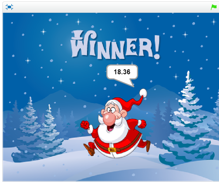

Step 6: Open the Scratch Software on Your Computer
Point your browser to https://scratch.mit.edu/projects/134861485/ to view the Whack-an-Elf project. This game is created in Scratch, a very simple to use programming environment for children. It will help them learn the basics of programming and logic, and it eliminates many of the headaches they might encounter in other environments. It is an excellent learning environment for kids, and it's fun for adults, too!
In the upper left hand corner of the game (directly below the title), press the "Fullscreen" button to switch to a larger view of the game. In browsers like Chrome and Firefox, you can also download extensions that will remove the "chrome" from around the window, giving you a larger viewable gaming area. The one I'm using in Chrome is creatively titled "Full Screen."
When you're ready to play, press the green flag in the upper right hand corner to begin the game.
When the game starts, elves, Santas, reindeer, and snowmen will pop up in random intervals from each of the presents. Use your hammer to whack the corresponding "mole" on your whacking box, and see how high a score you can get in the 30-second time limit.
