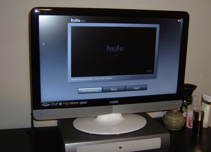

If your laptop still powers up at this point, you're in great shape. You can install your operating system and configure it to your liking. You can now decide whether you will install a tuner, DVD drive, etc. As with all computers, you have complete freedom to decide what you will do next.
My use for this machine is as a media center extender for the bedroom. My girlfriend and I can now stream movies from Netflix, catch up on our missed episodes of 30 Rock with Hulu Desktop, or watch any of the television programs recorded on the front room PC from the comfort of the bed. This little computer does a lot more than a typical extender. Another idea I'm toying with is using the onboard modem as an on-screen caller ID. At some point I'll be adding a firewire DVD drive to watch DVD movies.

So, how does it perform?
Why, thank you for asking. The performance is not as good as my main HTPC, but it's good. It choked a bit when I had it at 1920x1080 resolution (1080p), but works great at 1600x900. I think that the computer could benefit from another GB of RAM, 1GB just makes the minimum requirements for Windows 7. Where this box really shines is the noise level. My main HTPC sounds like a DC-9 by comparison. I have to struggle to hear any noise coming from the box when I'm standing right next to it, it's completely inaudible when we're watching it from the other side of the room. I'll leave the heavy lifting to the big box in the living room and this thing can stay on 24/7 without disturbing anyone.
