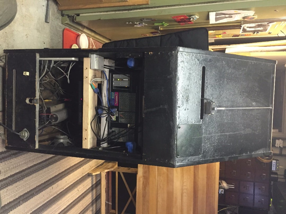

Step 3: Full Size Cabinet
Some time ago I built a Mame cabinet. The DWJukebox software works well on this too. Even though there is no touchscreen the trackball does the job. With a little config file tweaking the keyboard buttons and joysticks can be used too.
This one has a LOT of speakers. 4 tweeters, 6 midranges, and a JVC Titanium coned subwoofer. I used a standard Mosfet car amplifier to drive all the speakers. I had to use a large 12V 50Amp Mainframe Computer Power Supply.
Great sound and the Bass is incredible. I sometimes wonder why the hard drive doesn't crash from the vibration. I never did make a new Plexi cover for the monitor but I will get to that soon.

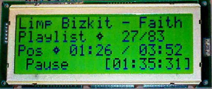

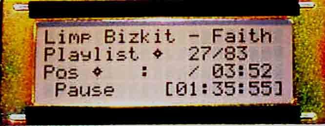

It has the option to log the current song info to a file. Then you can poll the file for changes and process it using you language of choice. I've done this before using things like LCD Smartie but with so many display skins I don't see the need for it.
Above you can see what it looked like with LCD Smartie and Winamp on a 20X4 LCD. I finally found those nice Black on White LCD's. They aren't backlit like the Black on Green one but they are so clear in a well lit room. When I looked in the file It had so little information that I never bothered to set this up.
