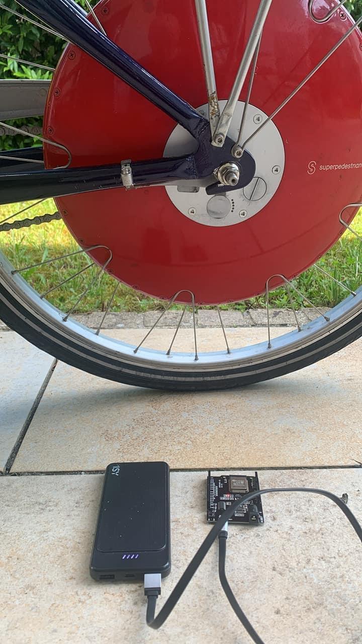

Step 4: Use the Key
Now you have a key that unlocks your wheel. I use a power bar to start the controller.
Power it up, bring it close to the wheel and switch it on. The wheel should start now with the default run mode. Maybe a reset of the board is needed sometimes.
The board will blink three times very briefly with the built in LED if the connection is successful. A failed connection is one brief blink.
Once the wheel is stated you can power off the controller and enjoy riding. As long as the wheel moves, the key is not needed any more.
