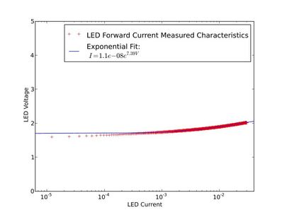

Here's a bog-standard diffuse 5mm red LED on a breadboard with the test setup, along with an image of the data the Python script outputs after analyzing the LED. IMPORTANT NOTE: the second "e" in the "Exponential Fit" line is Euler's number, 2.71828....The first "e" represents the exponent in scientific notation. So, represented another way, the first coefficient of the exponential function would be "1.1*10^-8." The LED current on the bottom axis is in amperes, and the plot is semilogarithmic on the X axis so each full division is ten times the previous value.
No big surprises here. The forward voltage of this LED is just under 2 volts for most of the current range, and it crosses 2 volts right at the upper limit of the scale, at around 20 - 30 mA.
What's going on at the bottom end, though? The generated exponential fit doesn't seem to fit the data very well down there. Here's what's happening: The actual diode current doesn't exactly adhere to an exponential curve. In the real world, all real components have parasitic elements that cause their behavior to deviate from an "ideal" model. In the case of an LED, the major player is the LED's internal resistance. As current through the LED increases, this internal resistance causes a voltage drop, which in turn causes the measured voltage across the LED to be _greater_ than what one would expect from a strictly exponential model. The curve fitting routine does its best to fit a curve to the data, but because of this nonideality it can't really do it, because the LED is not behaving in a strictly exponential fashion!
Because of this issue, the exponential fit generated is NOT really suitable for use as a SPICE model. To generate a proper SPICE model, one would calculate the LED exponential parameters at a low level of current where the ohmic term doesn't have much effect, and then calculate the value of resistance separately. Properly calculating the value of resistance from the measure data is somewhat tricky - hopefully it will be in the next version! The fit curve does, however, allow one to calculate a forward voltage for a particular value of current in the region where the curves overlap.
There is also an error due to the measuring setup. The current mirroring arrangement has an error because of the base currents of the transistors! The true current through the LED is approximately given by: (alphaQ3*Isense) - 2*(alphaQ3*Isense)/beta, where alphaQ3 is the alpha of transistor Q3 and beta is the beta (current gain) of transistors Q1 and Q2. Fortunately, so long as beta stays high over the region of interest, the error is not too bad. There is additionally an error due to the Early effect of Q2, but it is also relatively small.

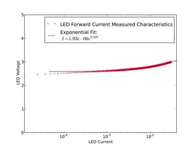

Here are the results for a no-name 5mm UV Led - unfortunately its deep violet color doesn't show up on camera and looks more blueish in the photo. As expected, it has a high forward voltage across its operating region, with a dramatic upswing in forward voltage as the current passes around 10 mA due to the previously mentioned ohmic resistance. One thing to remember about driving LEDs with DC currents is that almost all the "action" with respect to brightness happens at the lower end, and there's a region of diminishing returns where increasing the current does not increase the apparent brightness very much. For example, with this LED there is not a dime's worth of difference between its brightness at 10 mA and 30 mA, and yet the voltage across the LED increased substantially. There's no point in driving it with a DC current higher than is needed for maximum brightness - you're just wasting power! (Pulsed drive is another story, see: http://www.piclist.com/techref/io/led/pulse.htm ).

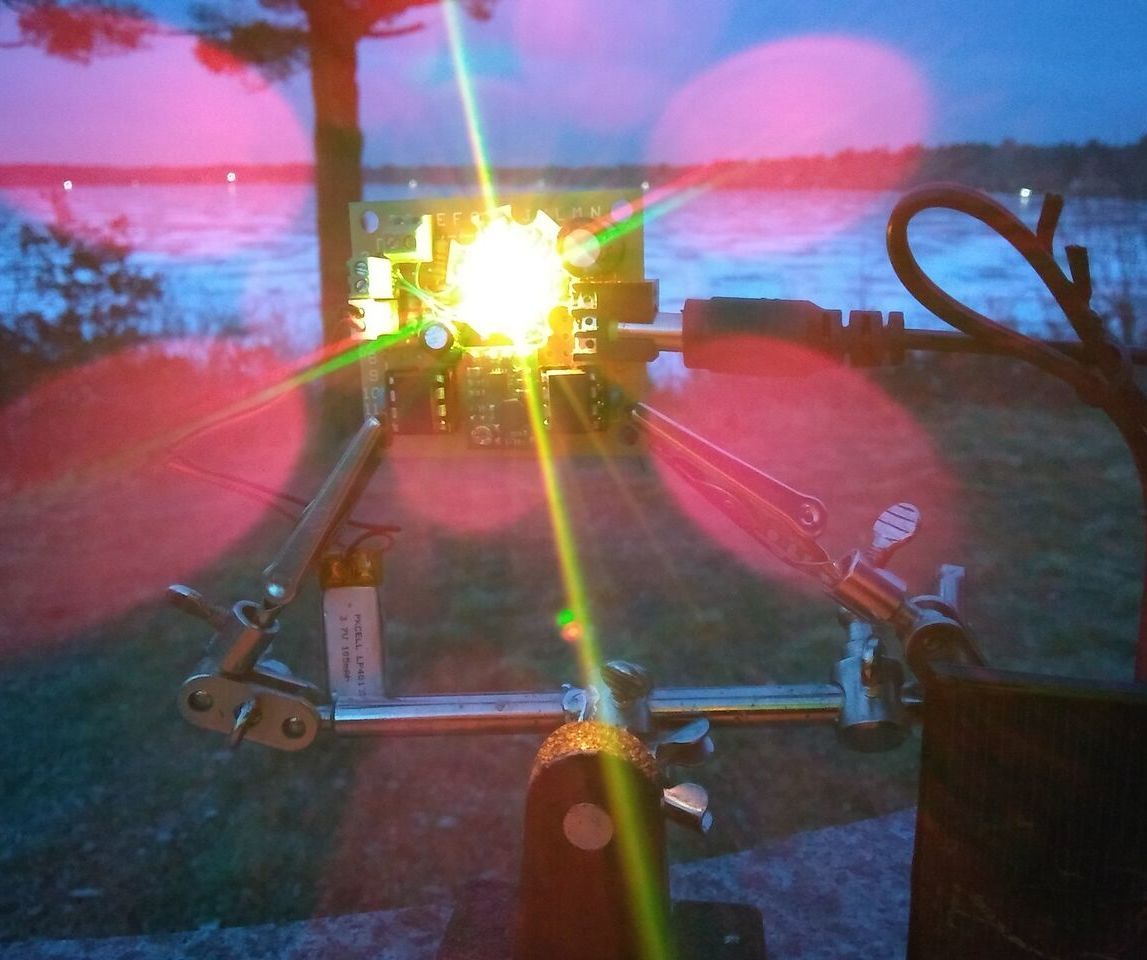

Here's a 5mm "Super Bright" Blue LED - everyone's favorite! It's characteristics are somewhat similar to the previous UV LED, but its maximum forward voltage is a bit less. It really is bright!

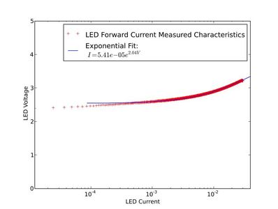

Here's the measurement of an unknown 5mm white LED. Its characteristics are quite similar to a blue LED - which is to be expected, since white LEDs are in essence blue LEDs with an added phosphor to emit yellow light in addition. The sum gives a white appearance.

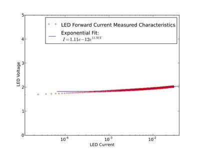

Something a little different: this is a 3mm diffuse yellow LED. This one surprised me as compared to the others it has far less "upswing" at higher currents compared to the others - its forward voltage rises very little over a wide range of currents. Perhaps the 3mm LED has significantly less internal resistance than the 5mm type? This might be a good LED to use, for example, in bias applications when one wants a constant voltage source over a wide range of currents. Of course, this tester doesn't have anything to say about what an LED's behavior over temperature changes is - all diodes are sensitive to temperature - but that's another project! It is possible to see small changes in the measured data if one, for instances, clamps the LED tightly between thumb and forefinger to warm it up while the test is running.

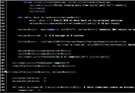

That's all the LEDs I had time to analyze as the LED contest submission deadline approaches! Getting this project up and running was a lot of fun, and lurking in what on the surface seem to be pretty simple devices is actually quite a bit of hidden complexity. I have included the code for the LED Analyzer, both the Arduino sketch, and the Python script which runs with it. Once the circuit is set up properly running the program is a breeze: just connect the Arduino via its USB to serial cable and run the script from the command line; options for selecting the COM port, baud rate, and number of iterations to run are available and are explained by running the script with the -h flag. The script does require a few add-on packages for Python to be installed such as matplotlib, Numpy, and PySerial; for Windows users I have created an executable using PyInstaller that will run as-is from the command line. It's available here: http://code.google.com/p/led-analyzer/downloads/list
