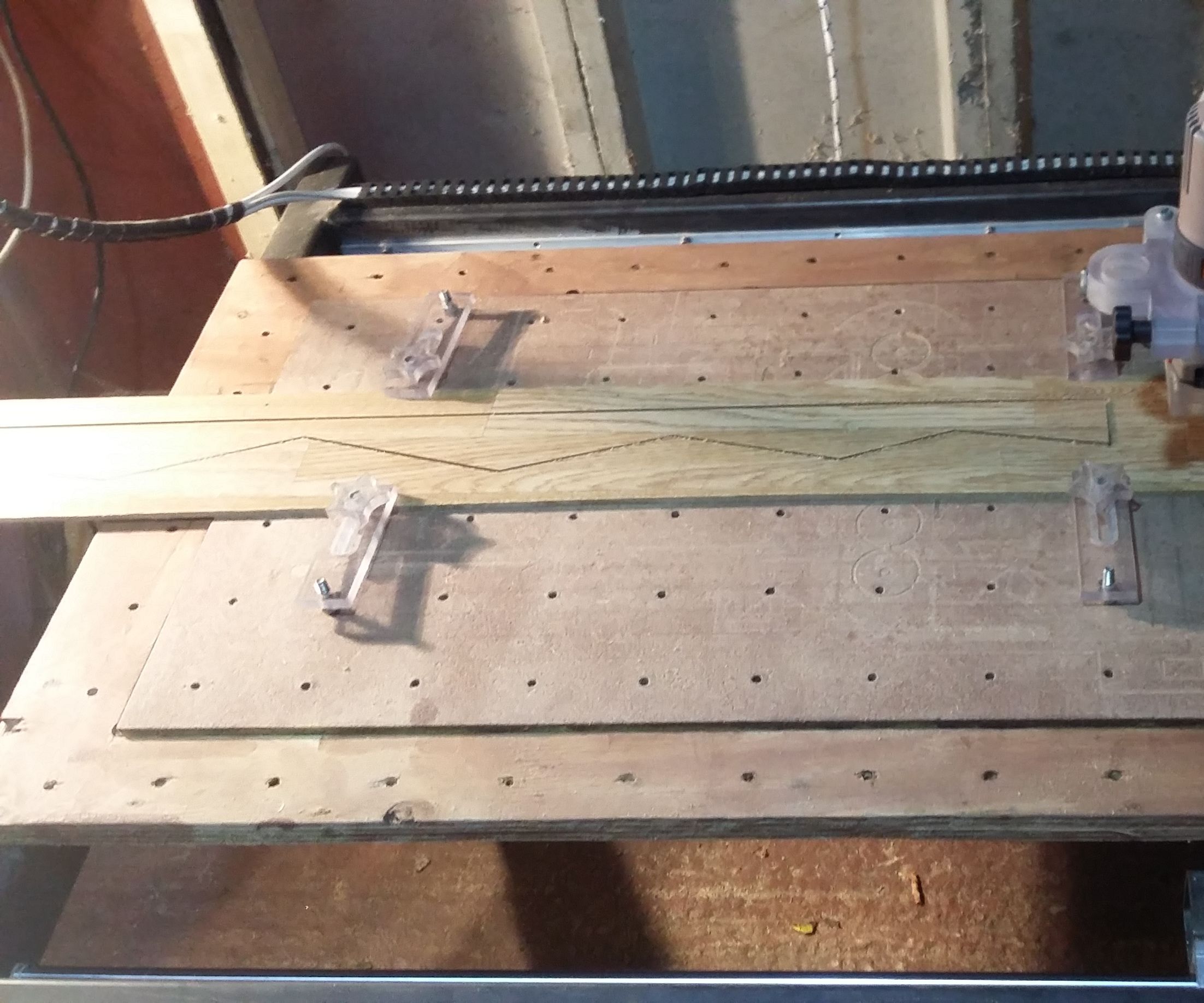

First on the list to be upgraded is the cutting bed. As I mentioned in the beginning, I don't want any part of this machine to absorb moisture and expand or shrink. I planed the cutting bed earlier in the summer and now it's all bumpy again. I'm considering replacing that with a 20 mm sheet of HDPE or ideally a 19mm tufnol sheet.
