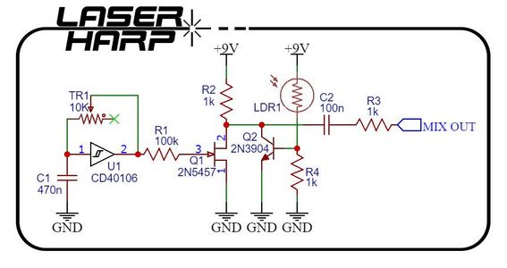

Let's start by building up a quick proof-of-concept on breadboard. We need an audio-range oscillator that can be tuned so lets start with a CD40106 CMOS chip and wire up a basic relaxation oscillator circuit using a 470nF capacitor from pin 1 to ground and a B10k potentiometer placed at the edge of the IC so that its wiper is connected to pin 1 and the high of the pot is connected to pin 2. If you only have larger pots just place it in the breadboard nearby and run jumper wires to connect to the chip. CMOS chips get grumpy if you leave their inputs floating so connect all the other inputs of the chip to ground. Then we need to limit the output current with a resistor, 100k ought to do it and for now run this to an output jack connected to an amp or powered PC speakers and lets check its making noise - watch out its likely to be loud! Make sure you can tune the tone with the pot. This oscillator works because the CD40106 is an inverter; feeding the output back into its input via a resistor-capacitor (RC) timing network makes the inverter oscillate from a high signal to a low signal very fast which you then hear as a square-shaped audio wave.
For this to work as an instrument the player needs to be able to turn on and off the sound from each 'string'. This is where the lasers come in - we will setup a circuit which turns the sound on when the player breaks a laser beam firing into a sensor. We can 'gate' the signal using a rudimentary filter made from a 2N5457 N-Channel JFET transistor in voltage-controlled resistor (VCR) mode and a capacitor. In this configuration when the voltage at the JFET's gate pin increases, the resistance between its drain and source goes down, resulting in the filter's cutoff frequency increasing. Connect the oscillator's output 100k resistor to the gate of the JFET and run 9V to its source via a light-dependent resistor (LDR) and lets test this circuit. You will find that when there is light hitting the LDR you can hear the sound, but when you cover the LDR the sound turns off. Great we've got the gate system working but its the opposite effect to what we want - the sound should be off when there is light hitting the LDR. To fix this we need to invert the signal from the LDR, which we can do very simply with an NPN BJT transistor, a common 2N3904 will be perfect. Connect the LDR to the BJT's base pin and the collector to the JFET's source and bingo, you've got a sound which is triggered by a broken light beam. The CD40106 is a hex inverter, meaning there are an extra 5 inverters on this chip we can use, so that will naturally set us up for a 6-'stringed' harp.

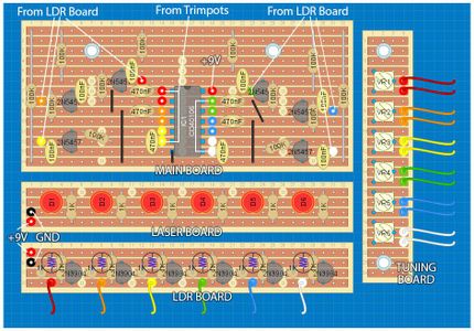

In terms of circuit boards we will need a strip to hold the 6 tuner trimpots, as well as two identical strips to hold the laser LEDs and the light-dependent resistors; and then we will need a larger board to house the integrated circuit chip and the rest of the components. We can get all 4 required boards out of just one standard stripboard piece which comes in a 37x24 size.
Mark out the stripboard using a permanent marker on both sides then score firmly down your lines with the heal of a strong craft knife; make a few score marks for each line, then simply snap off the pieces. To clean up the board edges you can use a rotary sanding tool, a file or sandpaper; I prefer to use a rough file and use the leftover pen marks to file down to.

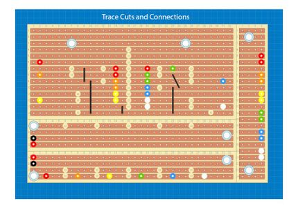

All that's left for the circuit boards is to drill away the copper strip according to the diagrams. Mark up the cuts; I'll go through each board and mark each cut on both sides of the board. I use a 3mm shallow tipped drill bit held in a hand-vice and generally make 3 or 4 turns to get the strip properly severed. I'll then run over all the cuts with the back of my tweezers just to free up and knock off any burrs and unwanted flashes of copper. Last job with the drill is to make the mounting holes; drill them slowly, a little from each side at a time so you don't tear away chunks of the board. Be sure to clean up any mangled flash copper from around all the holes.
Build 1 board at a time, adding components from smallest to largest. Don't attach the lasers or the LDRs just yet, you'll want to set them as square as you can once you have the enclosures printed; try to set the trimpots as straight as you can and keep internal wires neat. For the inter-board connecting wires, always start with more length than you'll need - you can always cut it down.
