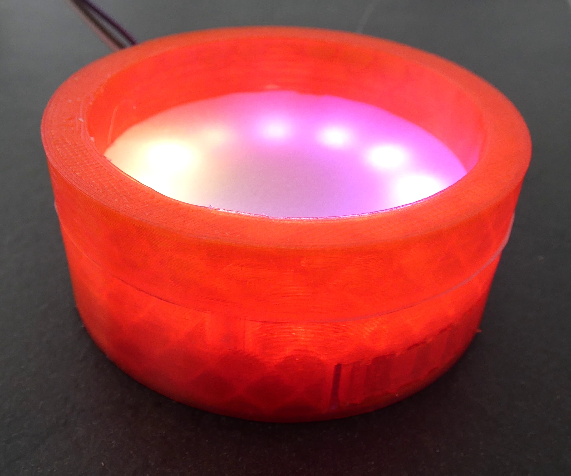

Step 7: Building a Case for the Module
You can build a simple box case for your module by laser cutting it in a 3mm plywood plank.
To make our box cases, we use makercase to prepare a template at the desired dimensions that we customize later. You'll find the svg file of the luminosity module attached to this step.
Then just glue the faces together excepting one so you can open it later, put your circuit inside and stick the LED in the hole of the case (we use transparent tape to fill the hole and diffuse the light in addition to stick the LED in front of it).
Now just add a battery to power your Arduino, close the case and your module is ready and should be looking good :)
