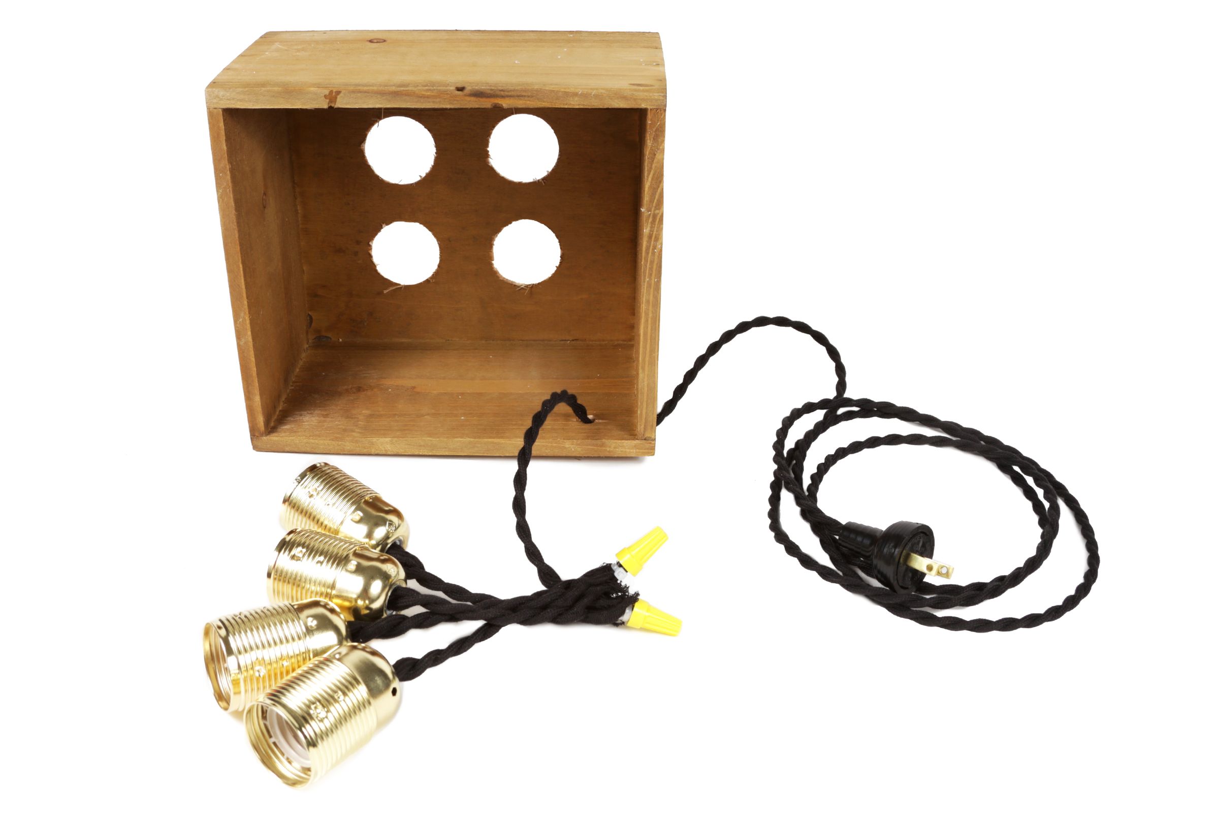

For the Mad Scientist Light you will need:
(x1) 9.1" x 8.1" x 4.9" wooden box
(x4) Brass flange sockets
(x4) 30 Watt Edison light bulbs
(x1) Power plug
(x2) Wire nuts
(x1) 10' of twisted pair fabric lamp cord

Measure and mark the top surface of the box such that it is divided into 9 equal boxes.
Make markings at the corners of the center square. These will be for drilling.
Step 3: Drill
Drill each of the four intersecting points with a 1-5/8" hole saw to make holes for the lamp sockets.
Step 4: Drill Once More
Drill a 1/4" hole for the power cord on the side of the box in one of the bottom corners. This is to pass the power cord through.

Step 9: Wire It All Up
Now is time to wire together all of the sockets in parallel with the power cord.

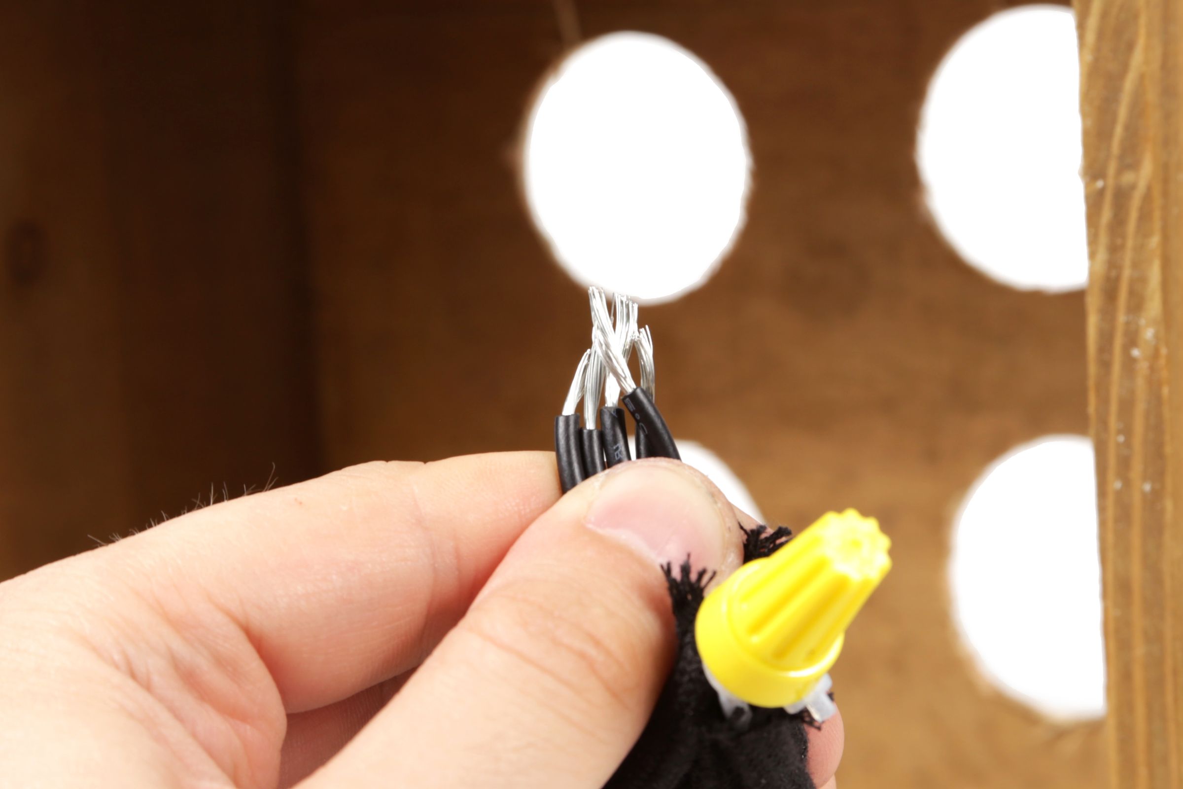

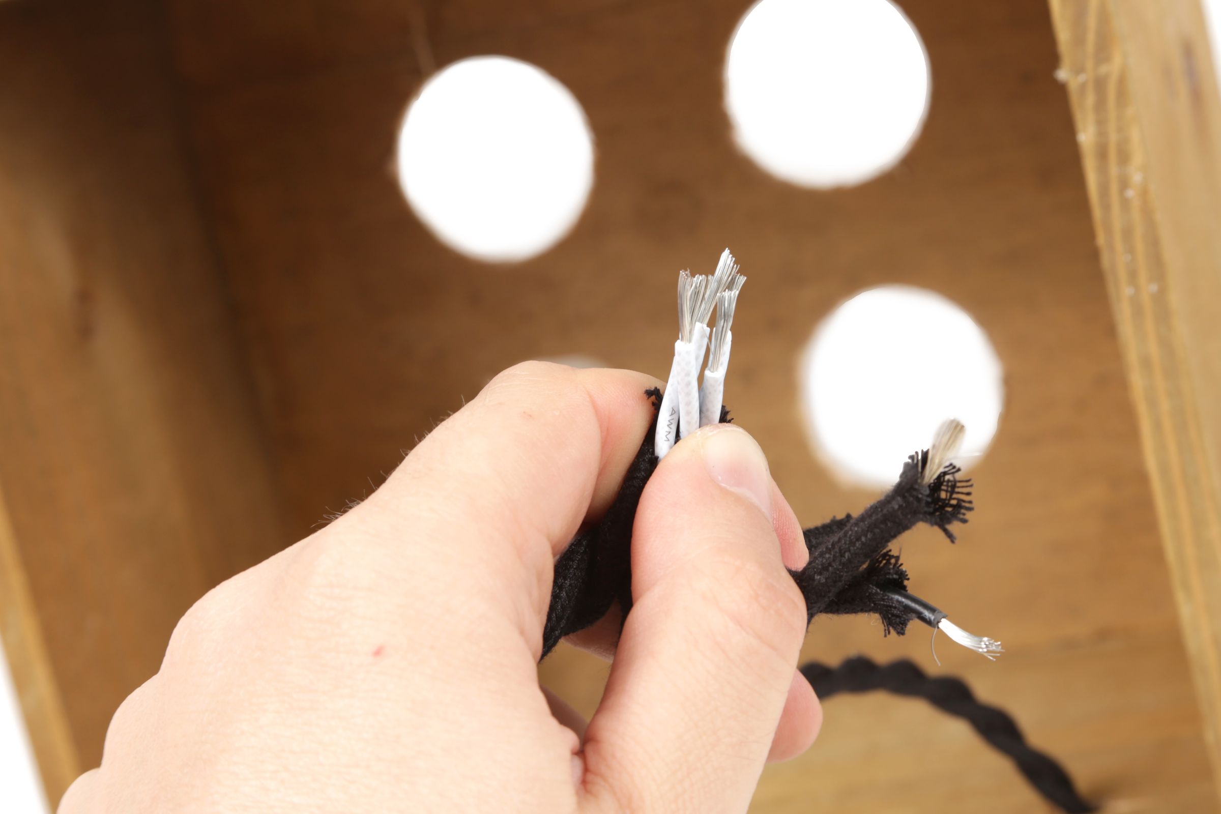

To begin, strip the insulation off the ends of all of the wires.

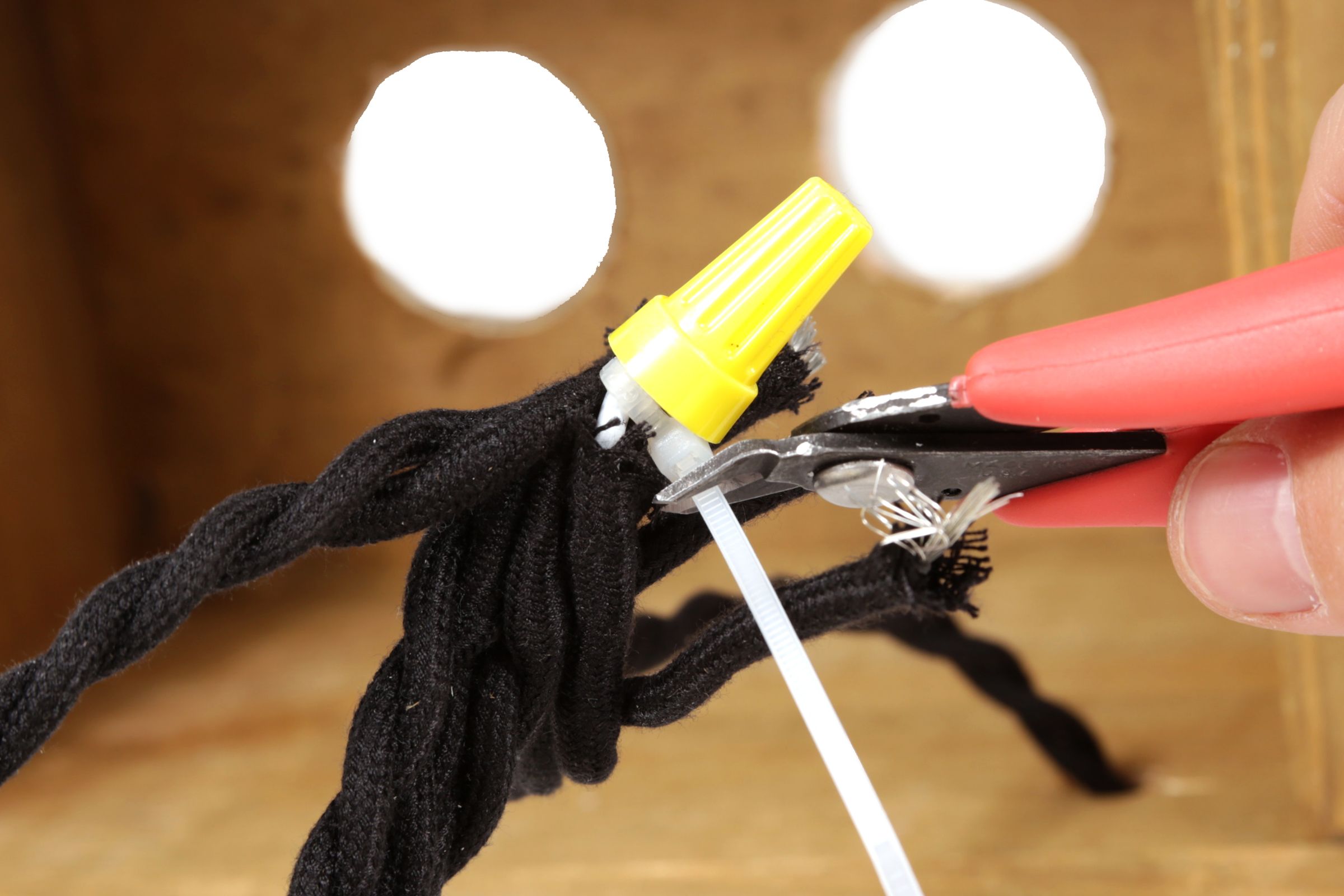

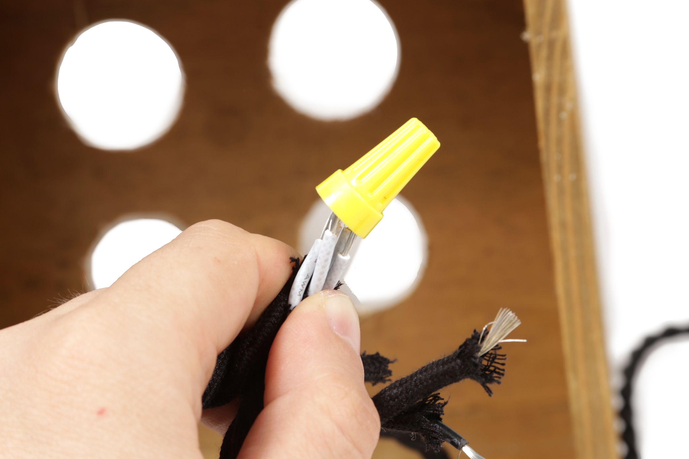

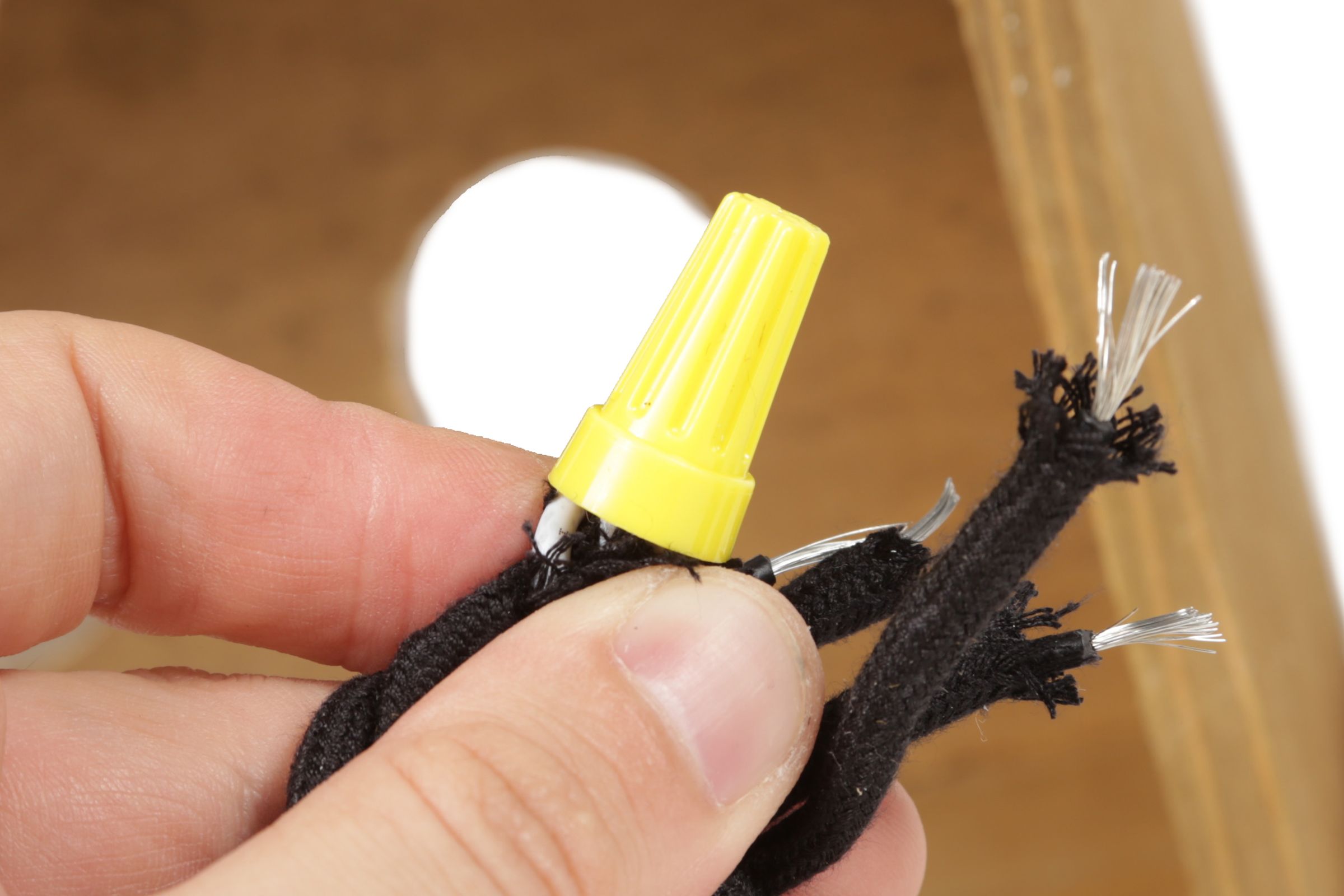

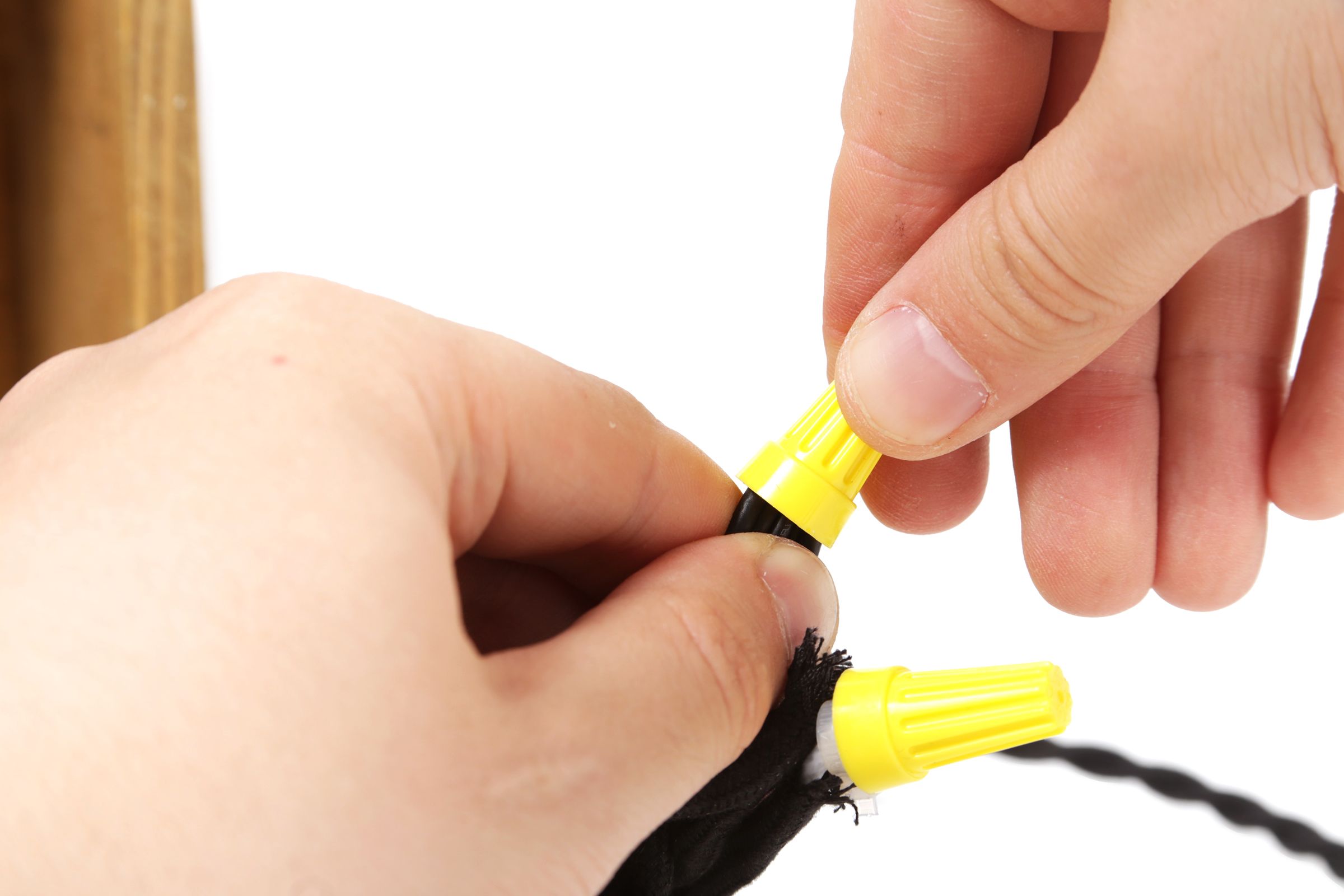

Bring together all of white wires from the lamp socket, as well as the white wire from the power cord. Twist a wire nut over the wires and give it a very gentle tug to make certain it is locked in place. Finally, attach a zip tie just below the wire nut as strain relief and to prevent any of the wires from falling out individually.
Repeat this process for all of the black wires from the sockets and power cord.
The wiring for the lamp should now be complete.
Step 10: Bottom Flange
Twist a flange onto each of the sockets so that the face of the flange is facing upwards.
Step 11: Top Flange
Pass the sockets through the box from the bottom until the bottom flanges catch.
Twist the top flange onto each of the sockets to hold them in place.
