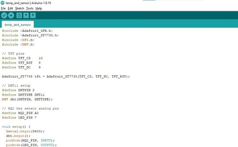

After you build these connections connect the uno board to computer via the programming cable and open the ide.
Use the arduino program given below, copy and paste the program to ide, select the proper board type in our case its the uno
Select proper port and if it asks for any library install it and click on the upload button and you are good to go.
After the program is done uploading test the circuit for working, Hopefully if you have followed the instructions well everything will work fine

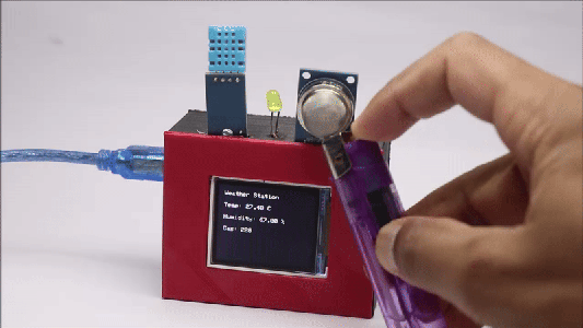

Connect the board to USB power and wait for some time, the LCD will stary to show the temperature and you cna expose the sensor to gas from a lighter and see if the led and the lcd are showing the signs.

Using this device is pretty much easy all you have to do is power this project with any type of usb power source.
Here to get the accurate results you may have to wait for about a minute, This is becuase the MQ2 sensor has a small coil inside that needs to be heated to detect the alcohol.
The temperature readings are almost accurate and i have cross checked with my phone also, You can see the same on the above step images also.
Since i was not camping and my gas was not leaking to showcase the working of alchol sensor i used a lighter gas that was exposed to the gas sensor.
Untill the gas detection happens to a certain readings the screen shows the real time value of gas being detected and upon a certain value being reached the led light glows up
There is also a alert message that will show in the screen, If you are sleeping then adding a buzzer along with LED will be more useful.
