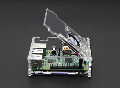

Step 3: Hook Up Your Device
After you install the OpenELEC, do as follows:
- Insert the micro SD card you prepared into your Raspberry Pi 2 (the slot is indicated by arrow #1 in the image below).
- Connect a network cable from your local network to the Ethernet port on the board or connect a WiFi dongle to the USB port on the board.
- Connect an HDMI monitor to the HDMI port on the board.
- Connect the power supply to the micro USB port on the board.
