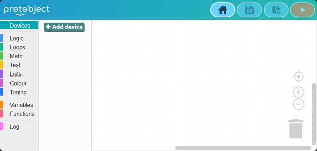

Step 1: Access Protobject Website
Open the Protobject platform at https://app.protobject.com using Chrome or any Chromium-based browser (e.g., Edge, Opera).
You can start using Protobject immediately, without the need to sign up or log in.

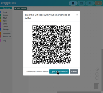

Step 2: Add Devices
  1. Add the Motion device by scanning the provided QR code with your smartphone. This device acts as a motion sensor and can be placed inside your pocket to detect movements!
  2. Add the WriteDraw device. You can scan the QR code with another smartphone, or click "Open in this window" if you want to view the indicator on your computer.
