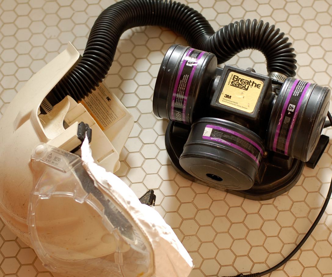

After a couple of days the panel seemed to be dry. I decided to cut it up into useable pieces on my table saw. I was able to cut 8 16" x 24" panels out of the big panel below.
Using the table saw was a mistake; while you get nice straight cuts that way, the starting panel was so large that it was difficult to work with and therefore dangerous. Due to my excessive use of glue, there were also pockets of liquid glue in the interior of the panel to surprise the unwary and gum up the table saw blade. I haven't tried this, but I think a regular hand saw would work fine (it's only cardboard, after all) and would be a lot safer.
