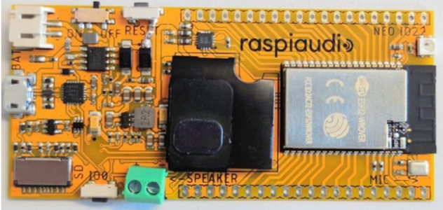

Just add the MUSE PROTO to the usb port, upload the bin file and play a bluetooth stream from your phone. No need to plug an external speaker as there is already a built-in speaker onboard. Upload the bin file (see the section uploading code)

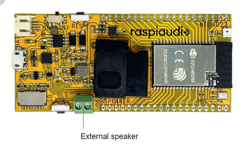

Add an old passive speaker, and a rechargeable battery. The sound quality is a zillion times better than the on-board speaker.
Use the green screw connector to plug to your speaker.Connect a JST battery connector (check the polarity on the board first look for the ‘+’)Upload the bin file (see the section below)

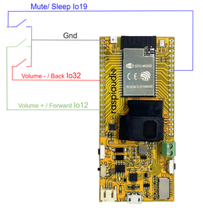

Step 7: Expert Level - Adding Buttons
This step is optional but doing this will give you the common on off button as well as up and down volume capabilities. You can also play the songs from a micro SD card and use a long press of VM and VP to change songs.
Buttons should be connected like this:
  • VM (gpio 32 / pin 8)short press => volume -long press => backward (SD mode)
  • VP (gpio 19 / pin 31)short press => volume +long press => forward (Sd mode)
  • MU (gpio 12 / pin 14)short press => mute/unmutevery long press => stop (deep sleep) / restart

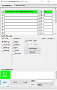

Now it’s time to download the pre-compiled firmware : https://github.com/RASPIAUDIO/museProto_speaker/r... It must be loaded using the ESP32 flash downloading tool https://github.com/RASPIAUDIO/museProto_speaker/r... Unzip it and execute Choose Developer Mode / ESP32.
Then select the path of the previously downloaded .bin file and set the loading address to “0x0”.

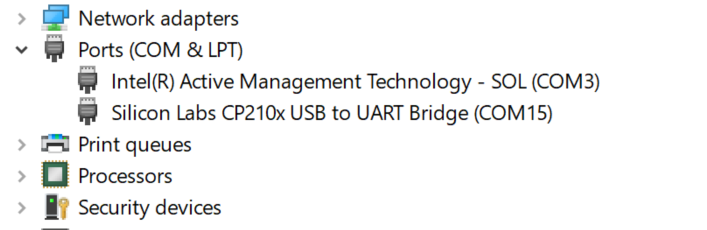

Finally connect the RASPIAUDIO MUSE PROTO via USB at the bottom select the right com port used by the connected board.
This com port number could change so if you are not sure of the com port go in windows 10 go to Device Manager and in the port section look for the number used by Silicon Lab…

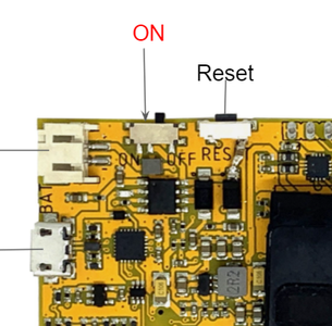

  • Check that the switch is ON position.
  • Click on START, it should now take 3mn to load.

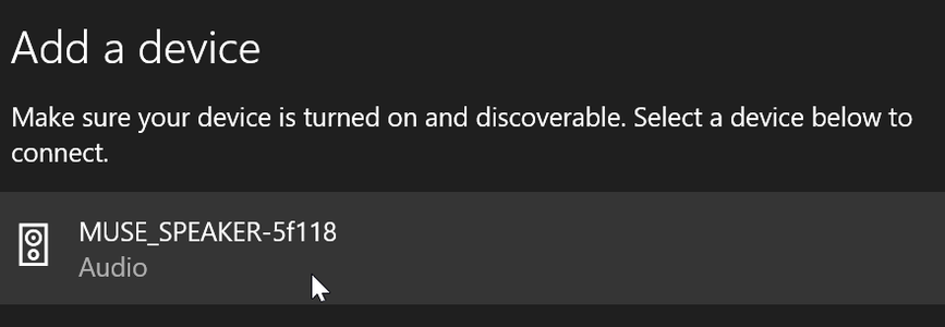

  • Now you can try it on any speaker and connect your phone or computer in bluetooth your board name will be MUSE_SPEAKER-xxxxx.
To try it you can connect a temporary passive speaker or just connect nothing and by default it will use the on-board speaker.

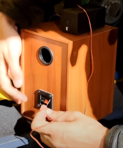

Step 10: Expert Level - Buy a Second Hand Speaker
If everything is working it’s time to visit a secondhand shop or yard sale to find a speaker.
The beauty of this procedure is that you can try the speaker in the shop before deciding to buy anything. Just prepare in advance 2 wires from 2 the green terminal to the speaker.
Finally i just added a nice handle and used some strong double-sided tape for the box.
