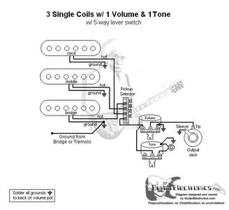

  • Soldering gun and solder (for wiring)

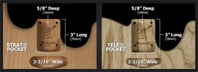

Neck Pocket
  1. Measure 3" down the center line from the top edge of the neck pocket area, and mark it
  2. From that mark, measure 28mm left and mark it
  3. Align the neck pocket routing template with the center line and these 2 marks, and attach it to the top using double-sided tape
  4. With the 1/2" pattern-bit, route the neck pocket to a depth of 5/8"
    Multiple passes, clockwise routing, be careful not to ding your template when lifting the router

Pickups/Pots/Switch
  1. Put the pickguard in place and mark the pickup, control, and screw locations
  2. Align your pickup template with the center line and marked locations, and route the pickup cavities with a top-bearing pattern bit
    For pickup types that hang from the pickguard (single coil, humbuckers, mini-humbuckers), go as deep as you want; for pickup types that attach to the body directly, measure the thickness of the pickup and route accordingly. For body-attached pickups, standard routing depths can be found online
  3. Use a 1" forstner bit to route the output jack hole
  4. Use 1 1/2" forstner bit to route the pot holes
  5. With the 1/4" bit, route a 1/2" connecting channel between the holes
    Make sure to leave plenty of wood around the pickguard screw holes
  6. With the same bit, route a hole for the selector switch, and a connecting channel to the neck pickup cavity
    If you're using a toggle switch, you can just drill the hole with a forstner bit

  6. Drill pilot holes for neck screws
    I drill these 1 bit size larger than recommended (3/16 instead of 9/64), to reduce the torque when mounting the neck; there's still enough "bite" to keep the neck in place, but the chances of snapping/stripping the screw are reduced. Templates for neck screw drilling can be found online. I'm not using a mounting plate, so I countersunk the screws and used washers.

  3. Install the pickups, pots, jack, and switch onto the pickguard
  4. Wire them up
    This article has a good overview for guitar electronics soldering, and diagrams for almost any wiring scheme can be found here. I included the diagram I used in the pictures.
