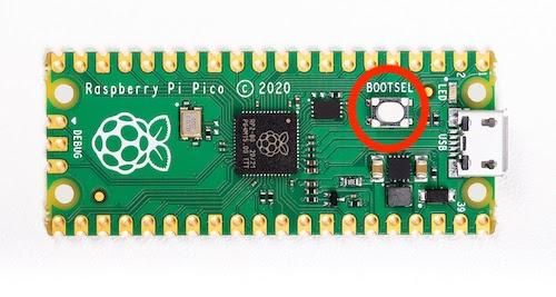

Then, enter bootloader mode by holding the BOOTSEL button while plugging the Pico into your computer via USB.

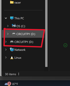

Once it appears as a drive named RPI-RP2, simply drag and drop the UF2 file onto it. The Pico will reboot and appear as CIRCUITPY, indicating that Circuit Python is successfully installed.

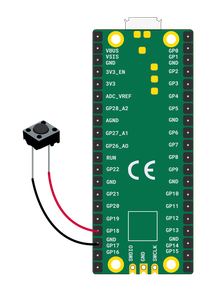

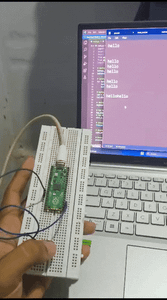

Here, i have used a breadboard, push button and jumper for initial testing. i have copied hello text and when i press the button, it's pasting the text. So everything is working.

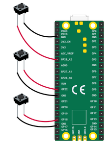

First i have soldered the female header pins to the dot board. then three push buttons are place according to the GPIO pin position. i have used GPIO 15,7,0. So i connected the pins to push button pins and GND pins are also connected.

button_pins = [board.GP15, board.GP7, board.GP0]

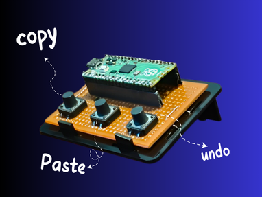

After all the soldering, i thought of setting up some type of wooden base. i used small piece of wooden log and cut a piece out of it. but it did not look pretty. The fact is there is no makerspaces in my home town to get access of any 3d printers. anyway i thought to design a case as an experiment. i used a CAD software and designed a simple case. suddenly i got an idea to make case out of acrylic. i took the design to nearby cnc shop and cut down the case, but it was a flop due to some dimensional errors of the top part.
Step 8: Final Outcome
I used the other parts and thought to kept it as a DIY design rather than a enclosure case. The key take away from this project is, i have learned a lot about HID interference and designing.
