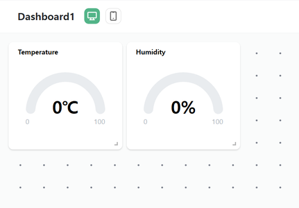

Step 3: Create Dashboard
Create a new dashboard. Add two gauge widgets and connect each to their respective variables:
  1. Temperature Gauge: Connect to temperature variable (Celsius)
  2. Humidity Gauge: Connect to humidity variable (Percentage)
Creating widgets takes just a few clicks, and you can customize the layout with simple drag-and-drop positioning.

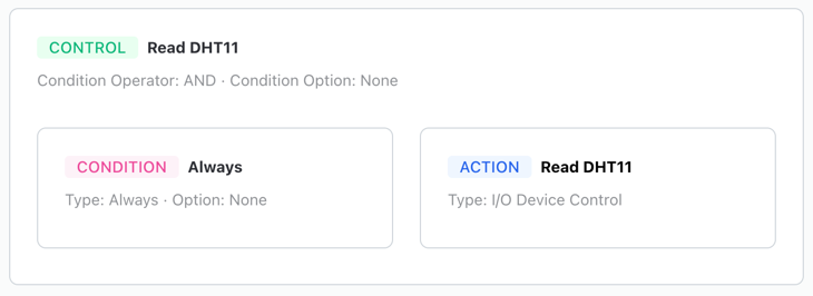

Step 4: Build Logic - Control1: Continuous Data Reading
Create new logic and add a control to continuously read temperature and humidity from the DHT11 sensor.
  1. Condition: Always (runs continuously in background)
  2. Action: Read DHT11 sensor from GPIO 23 and store the readings in temperature and humidity variables

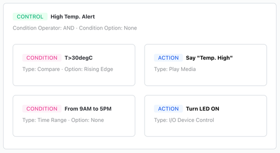

Step 5: Build Logic - Control2: High Temperature Alert System
Create a new control that triggers temperature alerts during work hours with the following conditions and actions
  1. Condition 1: Temperature exceeds 30°C (triggers only when temperature first crosses this threshold)
  2. Condition 2: Current time is between 9:00 AM and 5:00 PM (alerts only during work hours)
  3. Action 1: Play voice message "Temperature is high" through speakers
  4. Action 2: Turn on LED connected to GPIO 25 as visual warning

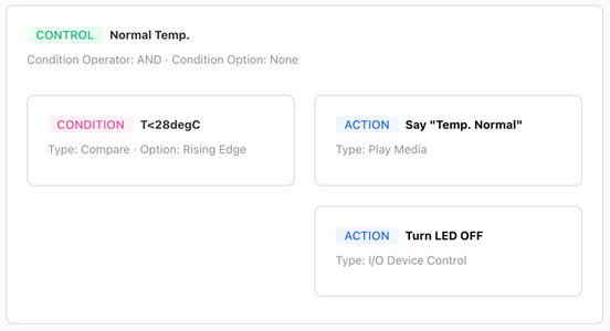

Step 6: Build Logic - Control3: Temperature Recovery Notification
Create a new control that clears temperature alerts when conditions return to normal
  1. Condition: Temperature drops below 28°C (triggers only when temperature first falls below this threshold)
  2. Action 1: Play voice message "Temperature is normal" through speakers
  3. Action 2: Turn off LED connected to GPIO 25 to clear visual warning
