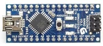

  1. Arduino Nano:A compact, breadboard-friendly microcontroller based on the ATmega328P. It's ideal for small projects, has USB connectivity, and offers 14 digital I/O pins, 8 analog inputs, and built-in serial communication.
