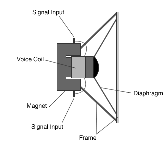

Step 1: Theory
For those who are unfamiliar: a speaker is based on the idea of electromagnetism; pass a current through a coil of wire and create a magnetic field. by placing a permanent magnet in the middle of this coil, and the active wire will be attracted to it. If the current that is passed through the coil has the form of an audio signal, the coil will move up and down to match the wave. When this coil is attached to a cone, also called a diaphram, the cone will create vibrations in the air. These vibrations are sound waves.
The output of an mp3 player is not powerful enough to create a strong field, so the amplifier circuit will boost the output to usable levels.
Parts Of a Speaker
Parts Of a Speaker
