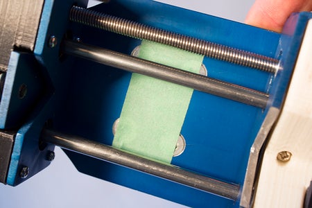

Step 5: Assembling the Lower Mount to the Frame
Using a drill, drill press, or rotary tool equipped with a countersink drill bit, countersink the 4 holes for the stepper motor mount in the frame until the countersink screws sit flush.
Fit 2 M5 nuts into the nut traps in the bottom mount. These will fit tightly if you've used M5 x 4 nuts.
Place 2 of the M3 x 15 screws in the screw holes on the front of the bottom mount.
Line the screws in the bottom mount up with the holes in the frame and fit together.
Fasten with M3 nuts and tighten.

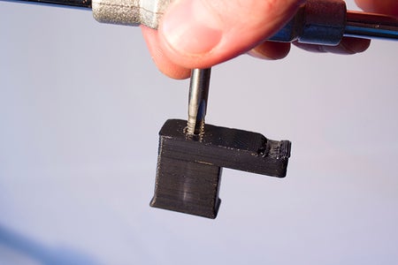

Thread the hole in the spring clamp with an M6 x 1.0 tap.
If you have not already threaded the spring clamp pin, do this now with an M6 x 1.0 die.
Screw the spring clamp pin into the spring clamp and tighten.

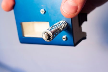

Fit the spring clamp through the hole in the front of the bottom mount.
Place the large spring on the spring clamp pin on the back of the extruder.
Using a washer, compress the spring and fit the M6 circlip into the circlip groove on the spring pin. You may need someone to help you compress the spring.

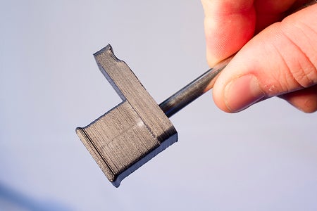

Push a linear bearing into one of the holes in the sliding clamp. It should fit tightly and require some force to move, but depending on your print settings you may need a little sanding to get it in.
Repeat with the second bearing.

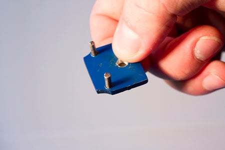

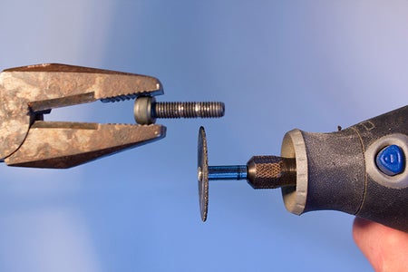

Cut or saw the tops of 2 of the M3 x 15 screws.
Leaving 3mm of thread on one side, grind or sand the threads off the screws until reasonably smooth using a rotary tool, grinder, or sandpaper.
Using a small amount of Loctite, fasten the screws into the sliding press clamp until they are flush.

Fit the top mount on to the ends of the linear shafts and threaded rod and ensure the screw holes of the top mount and the frame are aligned. If not, you may need to carefully widen out the holes for whichever linear shaft or threaded rod is not sitting flush in the top mount with a drill.
Insert the 2 M3 x 20 screws into the holes in the front of the top mount and through the frame. Fasten with M3 nuts.

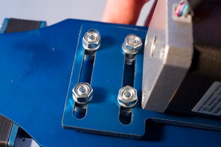

Loosely place the GT2 belt around the GT2 pulley on the stepper motor, and line up the mount with the screws.
Place an M5 split washer on each of the screws.
Loosely fasten with M5 nuts.
Step 14: Tensioning the Stepper Motor
Adjust the positioning of the pulley on the stepper motor until the belt is lined up with the pulley inside the frame and then fasten the grub screws.
Slide the stepper motor mount along the screws until the GT2 belt is taut. Tighten the M5 nuts.

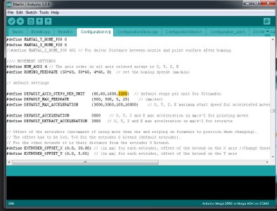

Step 17: Modifying Firmware
If you do want to make firmware changes, consider making a backup of your current firmware and settings to easily revert back to when switching back to a plastic extruder.
The following are settings for the Marlin firmware for the MendelMax 2.0 which can be found here: http://www.makerstoolworks.com/support-and-docs/d...
Open up Marlin in the Arduino, and navigate to the Configuration.h tab. Search for the #define TEMP_SENSOR_0 line under Thermal Settings. Change this value to 0 to disable the temperature sensor for the primary extruder, and add a comment so you can find this change later. You may also wish to disable TEMP_SENSOR_1 if you are using two syringe extruders.
This may cause the extruders to read a random value in your host program, however their values are not relevant to the printing process.
Still in Configuration.h, navigate to #define HEATER_0_MINTEMP line, and either set the value to a low non-null value, or comment out the line to disable it. This setting is to ensure that the connection to the thermistor is not broken, however as the syringe extruder does not have a thermistor this check is not required. Again, you may wish to make this change for HEATER_1_MINTEMP if you are using a second extruder, and add a comment so you can find this change later.
Just below this is #define HEATER_0_MAXTEMP, another temperature safety check for protecting the hotend from overheating. You can choose to either comment this line out or modify the setting to a large number to stop this safety measure from activating. As the disabled thermistor may still read a value this feature may still be activated, however it will only turn off the heater for the hotend which the syringe extruder does not have, but it should still be disabled so your print host does not encounter any errors. Again, comment and repeat for HEATER_1_MAXTEMP if using a second extruder.
Further down in Configuration.h is a setting called DISABLE_MAX_ENDSTOPS, which you should un-comment if you are using an endstop with your syringe extruder. This will allow you to re-assign this endstop for a custom filament exhausted code that will allow you to switch syringes while printing when they run empty.
Navigate to Movement Settings, and find the setting DEFAULT_AXIS_STEPS_PER_UNIT. The value on the end is the number of steps per mm for the extruder. If you are using a 1.8 degree/step motor with 1/16 microstepping, this value should be 3200, and for a 0.9 degree/step motor this will be 6400.
