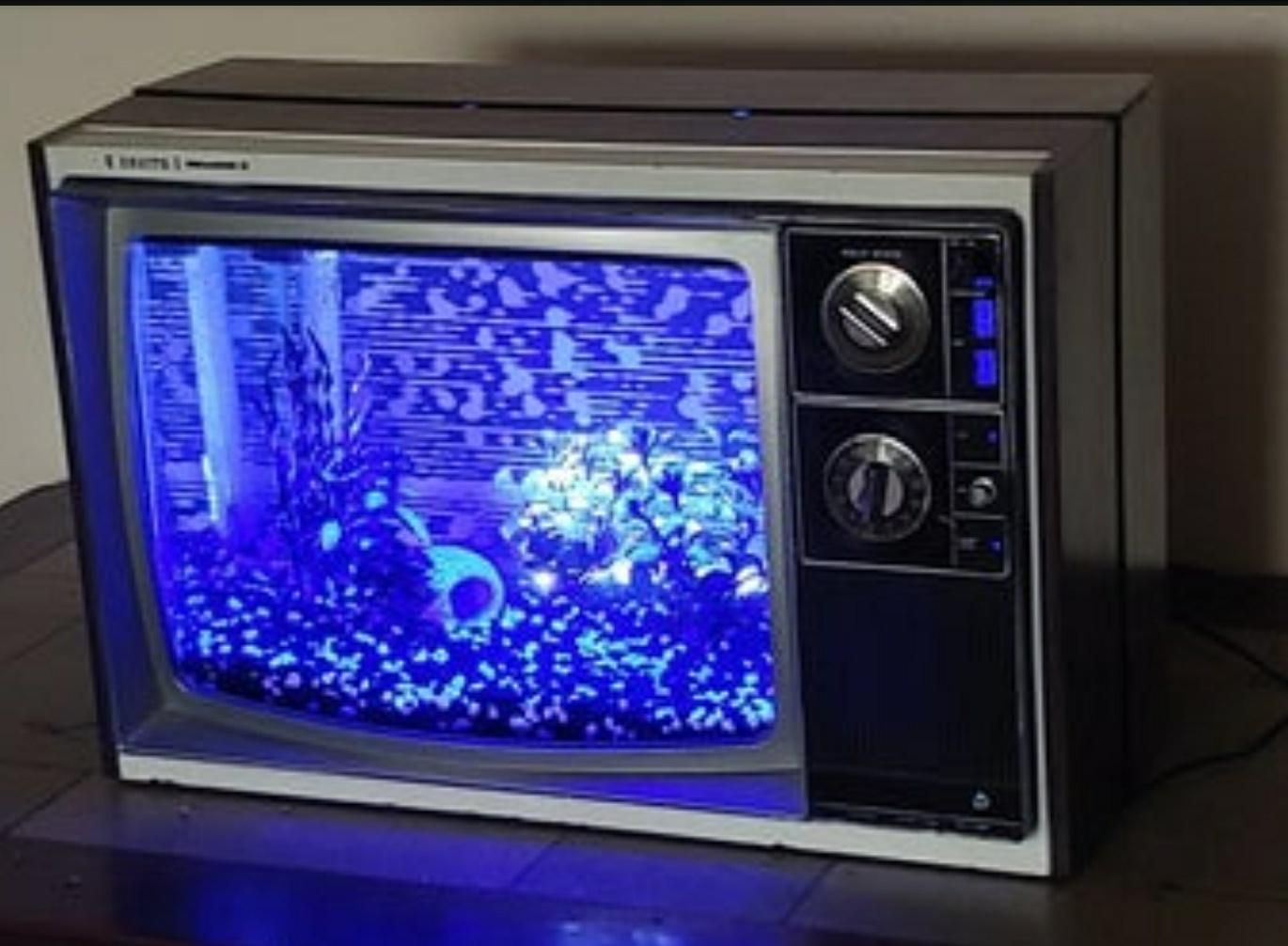

1 year ago on Step 6
I like your setup. This is my TV tank. I went with a static motif.

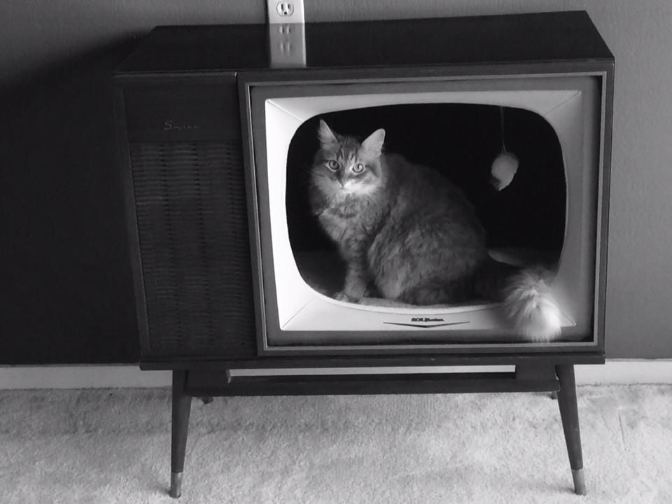

5 years ago on Step 6
looks fantastic! i had wanted to do the same thing for years, but was instantly overwhelmed with aquarium aspects and opted for a cat condo instead (kittyvision) the cat toy attached inside top of set moves with manual channel changing. i have another old console to make one more - it will have a remote for the channel changing (cat toy movement control)
