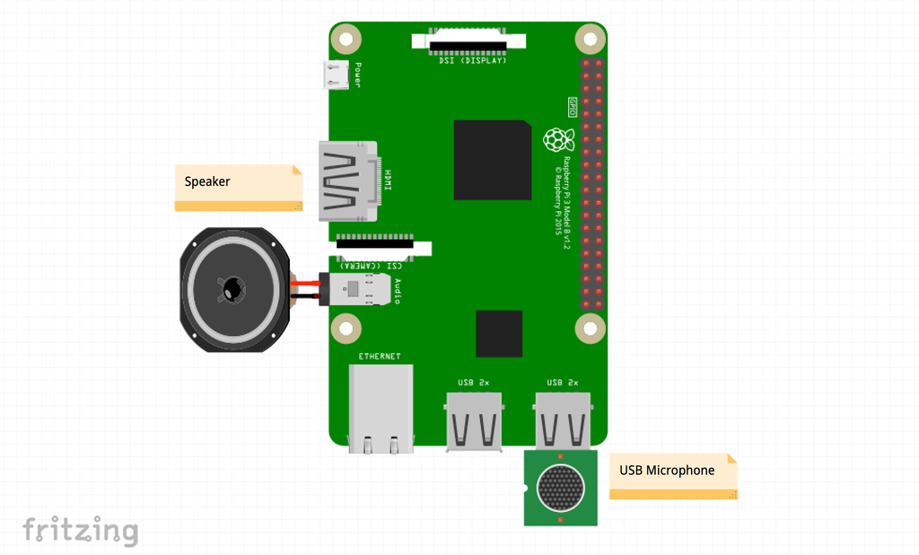

Once your TJBot is ready, plug in your USB microphone and the speaker.

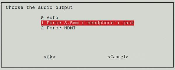

Depending on which audio output source you are using with your Pi (HDMI, 3.5mm audio jack, Bluetooth, USB speaker), you may need to set the audio config.
HDMI/ 3.5mm Audio Jack

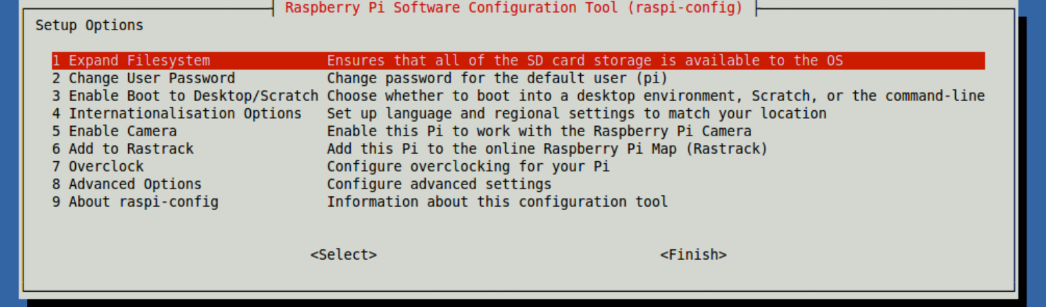

If you use HDMI or 3.5mm audio jack, you may need to set the audio config. To do this, go to the terminal and open up raspi-config.
 sudo raspi-config
This will open up the Raspberry Pi configuration screen:
Select "Advanced Options" and press Enter, then select "Audio" and press Enter. Choose the correct channel for the output audio. If you have connected an external speaker to the audio jack, you should select 3.5mm jack.
