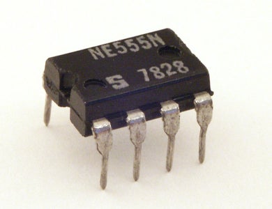

Step 1: Insert the 555 Timer Chip Into the Snap Circuits IC Socket Block
The 555 Timer IC was introduced by a company called Signetics (later bought out by Philips) in 1972 and was designed by Hans R. Camenzind in 1971. The 555 chip has 25 transistors, 15 resistors and 2 diodes in an 8 pin DIP (Dual In-line Package) and looks like a square bug with eight legs. It has a notch at the top and Pin 1 is in the top left corner. (See picture 1) (Source: http://en.wikipedia.org/wiki/File:Signetics_NE555N.JPG)

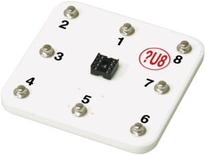

The Snap Circuits Eight-Pin IC Socket block is picture 2 (source: http://cs-sales.net/eiicso6u8.html)
Insert the 555 timer chip into the Snap Circuits Eight-Pin IC Socket block. Make sure that the notch in the top of the 555 timer chip is aligned with the diagram of the chip pictured on the IC socket block. (See picture 3) (Source: http://www.snapcircuits.net/learning_center/designer)

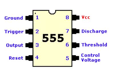

Step 2: 555 Timer IC Pins
The following are the pin outs for the 555 Timer IC (source:
http://www.markallen.com/teaching/ucsd/147a/lectures/lecture4/5.php):
Pin 1 is ground. It is connected to the negative side of your battery or power along with any other components in your circuit connected to ground.
Pin 2 is the Trigger pin. It will be connected to ground and thus switches on pins 3 and 7.
Pin 3 is the Output pin. In this circuit it outputs a square wave signal that can be heard on a speaker.
Pin 4 is the Reset pin. It is not used in this circuit. See http://en.wikipedia.org/wiki/555_timer_IC or http://www.markallen.com/teaching/ucsd/147a/lectures/lecture4/5.php for more info on this pin.
Pin 5 is the Control pin. It is not used in this circuit. See
Pin 6 is the Threshold pin. The 0.02uf capacitor C1 will charge up and when it reaches about 2/3 Vcc (voltage from the battery), this is detected by the Threshold pin. This will end the timing interval and send 0v to the Output pin 3 (switches it off).
Pin 7 is the Discharge pin. This pin is also switched off by the Threshold pin 6. When pin 7 is switched off it cuts the power to the 0.02uf capacitor C1 which causes it to discharge. Pin 7 also controls timing. Pin 7 is connected to the 100K ohm resistor R5 and the Variable resistor. As you move the slider on the Variable Resistor RV, it changes the amount of resistance in the circuit. This changes the timing of pin 7 and thus changes the pitch of the square wave heard on the speaker.
Pin 8 is connected to the positive side of your battery or power along with any other components in your circuit connected to positive.

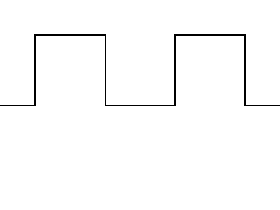

This process repeats creating the square wave signal (see picture) and you hear that signal from the speaker a tone.
