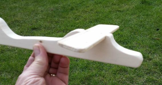

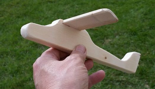

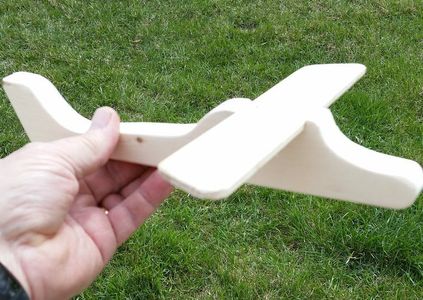

Step 2: Sketch the Airplane and Cut It Out.
  1. Hand sketch the fuselage on the board, this time I had an old one nearby I just used as a model. The shape really isn't that important, as long as it has a tail and a wing you'll be alright.
  2. Cut the fuselage out, make the slot for the wing a little small so you can trim it later for a nice tight fit.
  3. Use the wing material to get the right size slot cutout. The tighter the slot the stronger the airplane.
  4. Cut the wing out, I made mine about 20cm (8") long, and tapered the ends.
  5. Test fit the wing, use a chisel to clean out the cut and adjust the slot for a tight fit.
Step 3: Sand and Assemble
  1. I wrapped my sandpaper around a piece of scrap wood, that makes it easier to hold the sandpaper and to have better control.
  2. Hold the parts on a flat surface to sand. You'll get the sanding done faster and better than if you hold the parts in your hand.
  3. Hold the parts over the edge of a workbench to round the edges.
  4. Center the wing on the fuselage.
  5. Nail the wing on. Put the nails in at opposite angles, then the wing cannot be pulled off. The first planes I made didn't have a slot to hold the wing and after a while the wing would come loose. After I started the slot to hold the wing they haven't come loose. These planes have been thrown around trying to make them fly. Being made of pine they are light and don't hurt things. They can take quite a beating!
