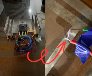

Step 6: Get Your Signal
  1. Take output from Pin 3
  2. Connect this to a buzzer, or the gate of a MOSFET to test it

Step 5: Testing
Power up your circuit.
Connect a piezo buzzer or small speaker to the output (pin 3) to hear the tone.
Turn the potentiometer slowly—you’ll notice a change in pitch.
If you have an oscilloscope or frequency meter, verify the output waveform and frequency.
