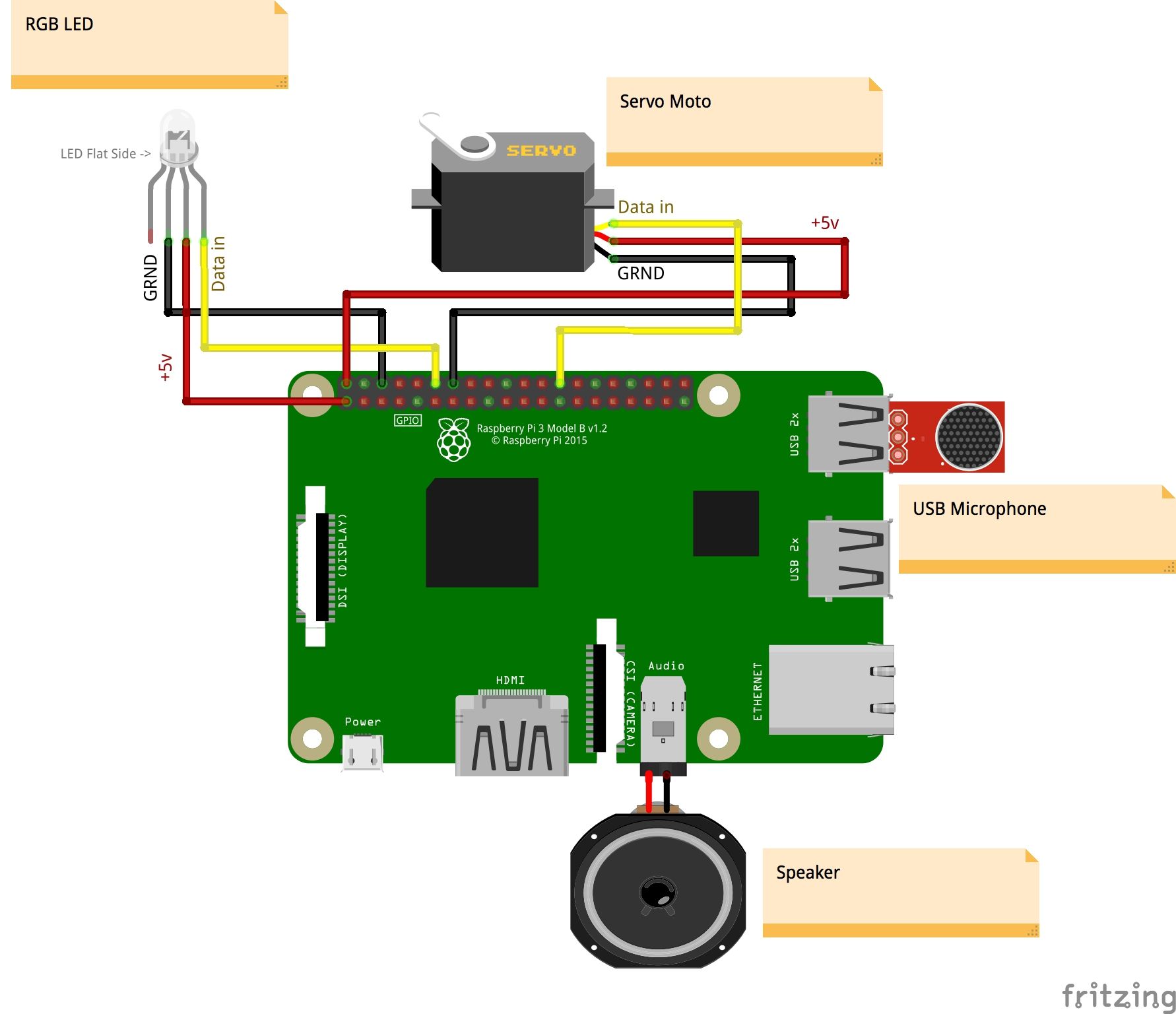

This instructable guides you through connecting a servo motor to your TJBot (or any Pi) and making your robot "wave", and "dance to a song" based on voice commands. You will use

Step 3: Step 3: Prepare the Kit
Assemble TJBot. Detailed instructions are available from another instructable here.
Once your TJBot is ready, plug in your USB microphone, servo motor and get ready to connect your LED to the Pi Pins.
Attention
It's very important to make sure you connect the RGB LED to the right pins, otherwise you may damage your LED or the Pi. ALWAYS start with the GND pin. GND is the longest leg of your LED. The LED has a flat side. The GND is the second leg from the flat side. Again if you are unsure, DO NOT connect the LED to the Pi.

Wiring Your Servo Motor
Your servo motor has three wires - Power, Ground and Data in. In this recipe I use the Tower Pro servo motor and the wires are as follows - Red (Power), Brown (Ground), Yellow (Data in).
For this recipe, a software PWM library is used to control the servo motor, and I wire my setup as follows.
- Red (+5v, Pin 2)
- Brown (Ground, Pin 14)
- Yellow (Data in, Pin 26, GPIO7 )
Note: In the code, you can always change the pins used.
