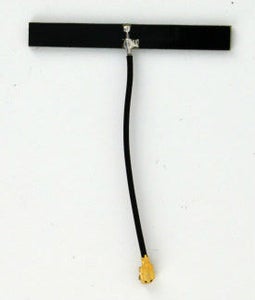

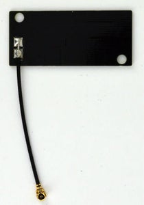

Step 2: LinkitONE Wireless Communication
A standard Linkit ONE package contains a Linkit ONE board, a chargeable battery, and three useful wireless modules (GPS, GSM, and Wifi/Bluetooth antennas).

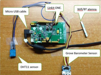

Step 4: Let's DIY a Weather Station
Today I built a weather station to measuring the atmosphere data and then upload to my cloud sandbox. The architecture of this small station is pretty simple. The computer supply power to linkit ONE and communicate with is by micro USB cable. For measuring data, I use Grove Barometer Sensor to obtain the values of the temperature and pressure of the atmosphere, and then calculating the ideal altitude of my station. Also, I measure the humidity in my room by DHT11 sensor, which is commonly used for Arduino sample. Finally, I wrote a program to upload the data to the cloud every few seconds with WiFi module, and I can just observe the variation of data through internet although I’m far away from my room.

Step 6: Preparation for Coding
You must include the SDK of Linkit ONE and the following three libraries to make this program works first.
1. Linkit ONE SDK
2. Arduino HTTP library
3. Grove Barometer Sensor library
4. DHT11 sensor library(see the attached file)

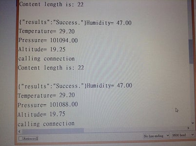

Step 8: Outcome on Serial Monitor. and If Succeed, It Will Upload Those Data Displayed on the Monitor
