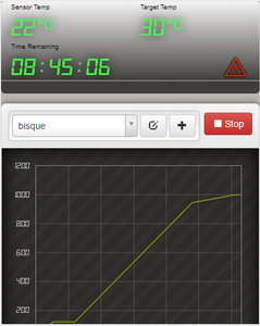

Step 4: Running the Web Server and Testing the Thermocouple
Time to start the web server. Type the following into your terminal window:
cd kilnController
python kilncontrollerd.py
You should see a couple of lines saying something like:
2019-01-10 21:49:20,006 INFO kilncontrollerd: Starting kilncontrollerd
2019-01-10 21:49:20,024 INFO oven: import MAX31855
2019-01-10 21:49:20,036 INFO oven: init MAX31855
2019-01-10 21:49:20,074 INFO kilncontrollerd: listening on 0.0.0.0:8081
Now, go to a mobile phone or computer that's using the same wireless network as the pi. Open a web browser and enter the IP address you wrote down earlier, followed by a colon and the port number 8081. For example: 192.168.1.91:8081
After a short wait you should see the temperature displayed on the top left of the web page. Warm up the thermocouple sensor by holding it in your hand or putting it on a lamp or a soldering iron. You should see the temperature increasing at 1 second intervals.

If it's not already running, start up the kiln controller software on the pi. Select a profile and click on 'Start' on the top right and then on the 'Start the firing' button on the Firing Overview modal.
Now, the bisque profile I've set up has a start temperature of 30 degrees Celsius. I live in Tasmania, where it's almost always cooler than that so the controller should immediately turn on the lamp to warm up the sensor. If you live in a warmer clime you might have to wait a while until the profile calls for something higher than your current ambient temperature. Either way, if everything's working to plan, you'll eventually see the light turn on and a 'kiln on' icon light up on the interface.
Leave it running for a while and you'll see the lamp turn on and off while the controller tracks the temperature profile.
