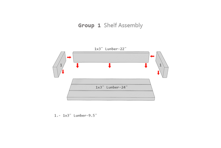

Step 1: Making the Wooden Shelves
First, gather your 1x3" lumber for each shelf: one piece at 1x3", three pieces at 24" long each, and two pieces at 9.5" long each.
Start by taking the 1x3" pieces that are 9.5" long and attaching them to the 22" piece of lumber. Use a basic butt joint for assembly. For added support, you can apply glue around the edges. Secure the parts together using 1 1/2” nails.
Once this part is assembled, take your three 24" long pieces of lumber and place them evenly on top of the assembled piece. Repeat this step for your other two shelves.

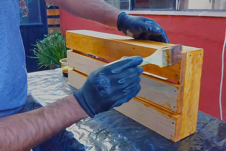

We recommend sanding and varnishing each shelf for a smoother finish. The varnish should be dry by the time you complete the next step.
Don't forget to wear your protective gear throughout the process.

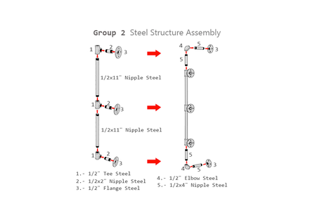

Step 2: Assembly of the Steel Structure
Next, we'll move on to the steel structure. For this step, you will need:
- Three 1/2" tee steel pieces
- Five 1/2" x 2" nipple steel pieces
- Five 1/2" flange steel pieces
- Two 1/2" x 11" nipple steel pieces
- Four 1/2" x 4" nipple steel pieces
- Two 1/2" elbow steel pieces
Start by taking your 1/2" x 11" nipple steel pieces and attaching a 1/2" tee steel piece to each end. Then, add the second nipple steel piece, followed by the last nipple steel piece.
Next, screw the 2" nipple steel pieces into the tee steel pieces and attach the flange steel pieces.
Now, take your 1/2" x 4" nipple steel pieces and screw them into the tee steel pieces. Attach a 1/2" elbow steel piece to each end, followed by another 1/2" x 4" nipple steel piece. Repeat this process on each end. Finally, add the flange steel pieces.
Repeat this entire step twice.

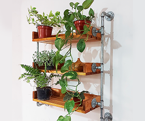

Step 3: Affixing the Shelves and Steel
Now, we'll attach the steel structure to the wooden shelves. Center and mark where you will screw the flange steel onto each side of the wooden shelf; drill carefully. Use 3/4" screws.
Once all the shelves are affixed, use the 3/4" screws to mount the shelf assembly to the wall.
How do you feel about this project? Above is how the Plant Shelf with Steel should look like.
