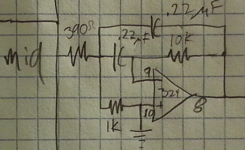

Step 4: Build the Mid Circuit
Next connect the 390 ohm resistor to pin one output. After connect both the .22uf capacitors to the resistor and one 1k resistor. Take one .22uf capacitor and connect it to pin 9 and to a 10k resistor. Next connect the the other end of the resistor to the second .22uf capacitor and to pin 8. Finally connect the 1k resistor to ground and to pin 10.

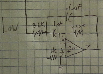

Step 5: Build the Low Circuit
Next take the pin 1 output and bring down to the 3.6k resistor. Next connect both the .1uf capacitors and the last 1k resistor to the 3.6k resistor. connect one .1uf capacitor to pin 6 and to the 220k resistor, then to the other .1uf capacitor and pin 7. Then connect the 1k resistor to pin 5 and ground.

Finally connect the output from pin 14 to the red cathode, connect the output from pin 8 to the green cathode, connect the output from pin 7 to the blue cathode. Then connect the ground pin to ground.
