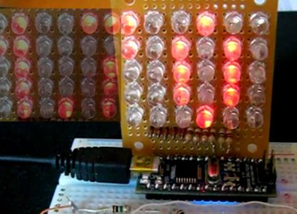

One of the newest member of the Arduino family is the 'Nano', shown here trying to say "HELLO" on the LED panel. It's got everything on a 2" x 1" (5 x 3 cm) package, and has its own USB connection.

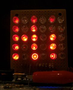

The LMP is 6-columns across by 5-rows down, totalling 30 LEDs. The size is chosen because this size Matrix is the smallest that can be used to display the English alphabet, and wide enough to be used for scrolling messages. It is also the largest matrix that can be built using ONLY the available output pins on 1 side of the Arduino package.
Technically: the columns are controlled by digital pins 2 through 7 (PORTD), while the rows use pins 8 through 12. This form of matrix addressing means that only ONE LED can be lit at any time, but allows us to control 30 LEDs individually without needing expensive multiplexing and addressing hardware.

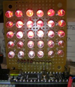

Begin with a 2" x 3" (5cm x 7.5cm) piece of perforated circuit board (perfboard) and arrange the LEDs as shown. Align the SHORTER (-) leads towards the top of the board, which I had marked with an arrow.
Making sure the LED is flat against the surface of the board, solder the negative lead ONLY. Do that for all 30 LEDs.
Now fold the longer (+) lead of each LED over to touch its neighbor and solder them together. You should have the + leads of 6 LEDs connected this way, all pointing to the right.

Bend the leads of 5 x 1N4148 diodes to come out the the space at the bottom, with the cathode (-), banded side pointing towards the LEDs. The anode (+) end will attach to the micro's pins. If you find the wires too flimsy as a connector, reinforce them with a heavier wire.
Attach the cathode ends by thin wires to the LED's anode (row) ends: pin 12, row 1; pin 11, row 2; pin 10, row 3; pin 09, row 4 & pin 08, row 5.

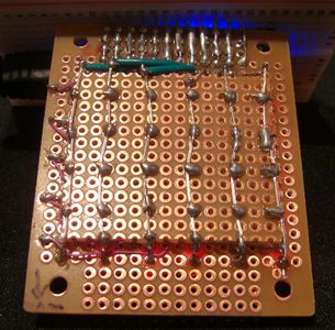

Step 5: Add the 2nd Layer + Column Resistors
To isolate the leads of the LEDs, cut a smaller piece of perboard to go over the connections you have already made. Do not make it any bigger than necessary.
Again, match up the pin connectors of the microprocessor with your matrix. Some microcomputer boards have an extra space between pins 7 and 8 and you must allow for that.
Join all the negative (cathode) leads of the LEDs vertically as shown below. Install the 6 resistors to match up with pin 2 (at the end) of the microprocessor with column 6. The other connections are pin 3, col 5; pin 4 col 4; pin 5 col 3; pin 6 col 2 and pin 7 col 1.
After you verified all your connections and trimmed off all the ends, your LMP is complete!
A quick test is to connect a 3 to 6volt source (like 3 or 4 AA batteries) and touch the + to a ROW (pins 8-12) and the - to a COLUMN (pins 2-7), ONE and only one LED should light up.
A word on the choice of resistor. The value (390-ohm) selected is for 8mA to go through the LEDs. This may seem low but the efficiency of the driving program make it unnecessary to use higher power. If absolutely needed, the resistor can be as low as 220-ohms.
Now, if everything looks OK, plug in your LMP, making sure (again) that pins 2 - 12 match up with the sockets on the Arduino. Then you can paste the following program in and see your efforts light up!
