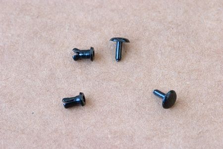

Wearing gloves, pull the modelling light out of its socket and set it aside. Pry out the two plastic pins in the side of the strobe and their locking collars with a knife blade. Very carefully slide the two halves of the strobe slightly apart. Reach from the side with needle nose pliers and gently wiggle the banana plugs of the flash tube out of the sockets. Wiggle one and then the other. Use a strong light so you can see what you are doing. Only the plugs are metal, the rest of the tube is glass. Slow pulling of the tube from the top can help, but should be done very cautiously. Remove the strobe's metal reflector when the tube is out..

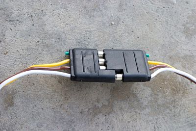

Step 4: Connectors
To allow the possibility of taking apart the zoom spot for storage, trailer light connectors were used. A five way connector would have handled all the wiring in one cable, but I made do with two used 4 way.
Cut the cable of a 4 way connector in half. Cut and remove one wire. To one half solder 2 banana plugs and a bullet plug. To the other half solder 3 ring connectors. This cable will connect the strobe and the trigger wire. Solder a female bullet connector to the trigger wire in the strobe.
Cut the other 4 way connector cable in half. Cut and remove 2 wires. Trim 2 ring connectors to make prongs and solder them to the cable. This cable will connect the modelling light.

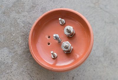

Step 5: Flower Pot Saucer
Flatten the copper plumbing bracket in a vice and make two fasteners to hold the saucer against the ellipsoidal reflector. Drill holes in the clay flower pot saucer for the banana sockets, trigger wire bolt, fasteners and modelling light. The 50 watt modelling light is very hot, so there can't be any plastic near it. Unscrew the plastic covers from the banana sockets. The wire that attaches the trigger bolt to the flash tube trigger wire should be bare copper or enamel coated.
Step 6: Testing
Use drywall compound or plaster of paris to cement the modeling light in place and leave it overnight to dry. The modeling light's leads will most likely not take solder. Crimp a small leftover piece of copper bracket around each lead with pliers, and solder to that. Hook up the other connectors to the saucer and the strobe, making sure there are no cross connections. Zip the cables to the case of the strobe to stop strain on the plugs. Turn on the strobe and test for arching and heat damage.
Step 7: Install Flash Tube
Use the copper brackets to attach the saucer to the hole in the reflector. Make sure they do not touch the metal base of the banana sockets or the trigger wire bolt.
