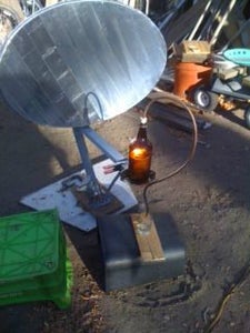

As you can see, the unit is the paraboloid, a 'mash' jug of an old brown quart beer bottle, a cork and length of copper tubing, and a collector bottle. This prototype shows sloppy work, in that the quart bottle is not well secured, and the collector bottle at bottom is setting on a stand. So, when it's time to adjust the parabola to track the sun, I have to lift off the lower bottle, move the parabola, and then move the stand and put the bottle back in place. Not very acceptable, and it is dangerous to be screwing around with hot bottles. Boiling hot bottles.
Also, note that I have placed the unit on a patch of dirt. That way if anything breaks, or catches on fire, it will hopefully be not so dangerous as on wood, for example. Please be aware that the collector bottle contents will get as high as 184 proof. At least that's my measurement for the first couple of batches.
AND NEVER set one of these hot bottles on a cold surface, or you may have hot and possibly burning alcohol all over. I DO have a fire extinguisher handy when I am playing around with this stuff.

The first test yesterday went well. I use about 28 ounces of standard cheap vodka in the mash jar, and it started boiling after about 15 minutes. It was an interesting boil, and it makes a bit of noise, too. You can see the bubbles clearly, however this photo was taken just as the autumn sun was going down -- you can see the shadow on the reflector. Also, I had to use a lower box to set the collecting bottle on, as the sun was dropping in the West, and the parabola had to be lowered.
The device gave out 3 ounces of distillate in about 45 minutes, and then the sun was gone. I should have started earlier in the day. However, this equates to 4 ounces an hour, which ain't bad IMHO. The still will just about double the % of alcohol as in the mash jar. IOW, if you put in a 15% wine, you should get out about a 30 to 35% brandy I am thinking. We all know, of course, that it is illegal to distill alcohol without a Federal Permit, and while I am with a group which has one, this test distiller was not done on that licensed property. I will henceforth make sure that any future distilling is also done there. I did however spoil the alcohol. You can do that by adding a spoon or so of toxic substance into the collector bottle. You can add some gas, or I like to use rubbing (isopropyl) alcohol. This is to keep the stuff from being drank, so that you cannot be accused of making 'moonshine', even tho' you actually have.

Here I redid the copper line, using a smaller diameter pipe, and ran it toward the back of the parabolic. I just drilled a small hole into a new cork, and pushed the copper tubing into it. And then I shaped and secured the new copper line with a wire tie.
Now that the collector bottle is away from the focal point of the parabolic, I don't have to worry so much about it possibly igniting and blowing something up. It probably would just burn, but I don't want to find out. Also, this is going to keep the fumes from the ethanol away from the hot spot, which was, before, just above it. The stuff measures at 82% so I don't want it near anything potentially hot enough to light it. And that means no smoking around it.
