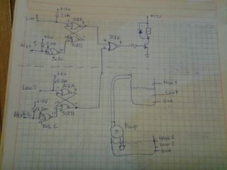

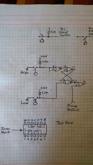

Step 1: Proposed Control Slide Show
The slide show included in this instructable shows the basic operating theory behind this control. It assumes that the pump is a small plug-in pump. This control has a small 12V coil relay whose contacts are rated at 10A 120V. You can select any relay to suit your water pump's power source.

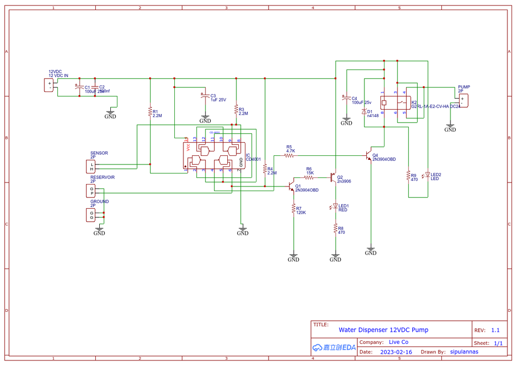

Step 3: The Schematic
This schematic was originally drawn using CadSoft EAGLE software for PCB design. As it seemed hard to read it has been modified for clarity. A small step-down 120Vac:12Vac transformer rated at 250mA feeds the on-board power supply through terminals X1-1 and X1-2. The transformer provides the low voltage required for the control plus galvanic isolation between control circuitry and the mains. In order to keep parts number at a minimum, a CMOS CD4001 circuit was used so only one supply voltage is needed for both, control circuitry and relay.
In addition to what was shown in the slide show, this control circuit includes two LEDs, one green LED to show when pump is running and a red LED to show when control is in pump protect mode. The green LED comes on every time the relay comes on. This LED –and its current limiter resistor- is in parallel with the coil of the relay. If red LED is on, pump and green LED will stay off even if pump is required to come on. Once red LED goes out then pump and green LED may come on if needed.
The circuit formed by transistors Q1 and Q2 is designed to turn on the red LED (Pump Protect) whenever there is no water between pump protect electrode and ground electrode at pump reservoir. Q1 comes on as soon as water level drops below pump protect. Q1 base current is too small, less than 1 micro Amp. Q1 and Q2 are wired as a Darlington pair so Q2 can turn on the red LED when required. Once there is water between pump protect and ground electrodes, Q1 turns off causing red LED to go out.
IC1-B gate works sort of an AND gate. This means, whenever main tank needs to be filled up and pump protect is false, this gate turns on transistor Q3 which will turn on the water pump.

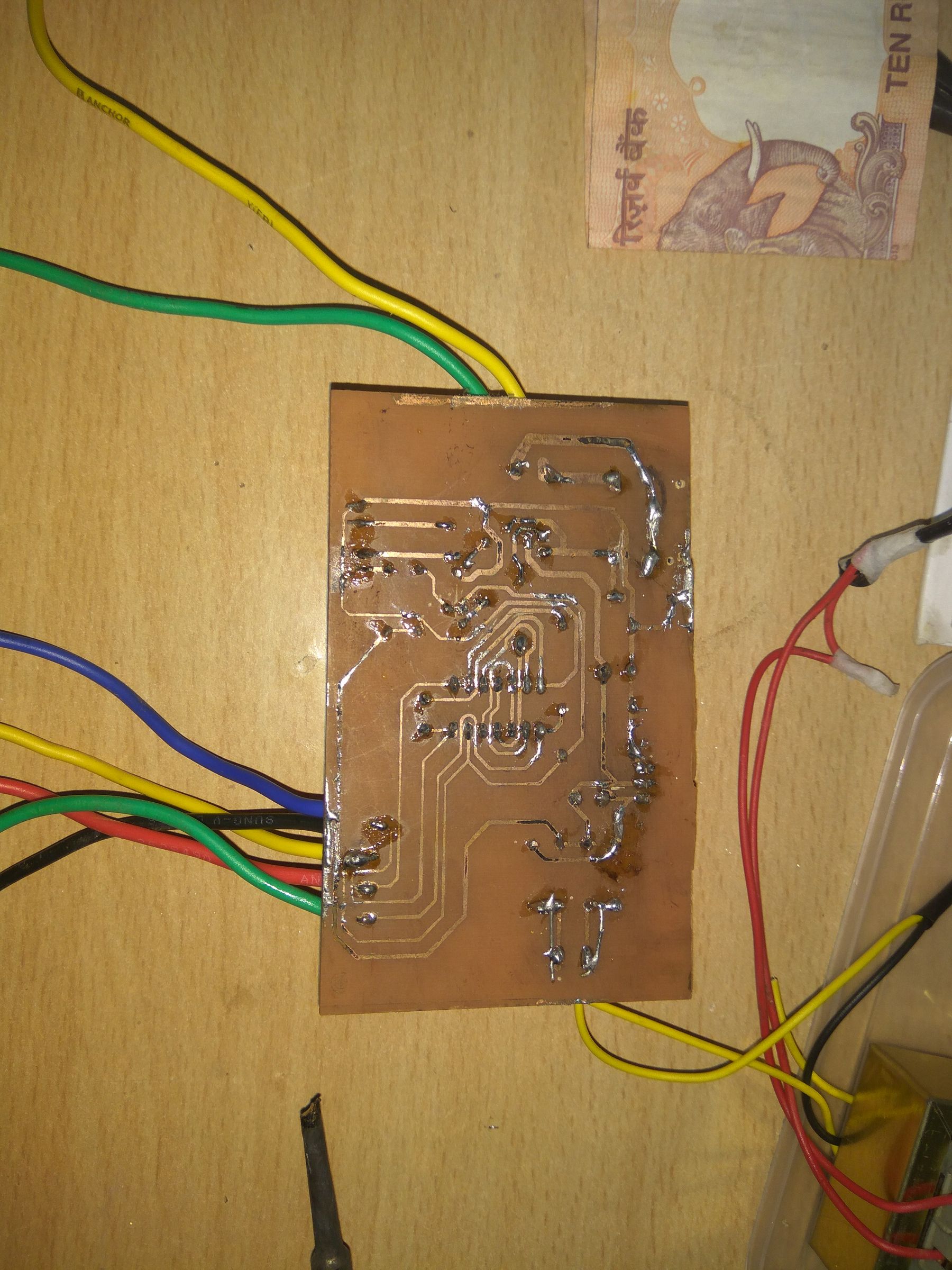

Step 4: The Printed Circuit Board

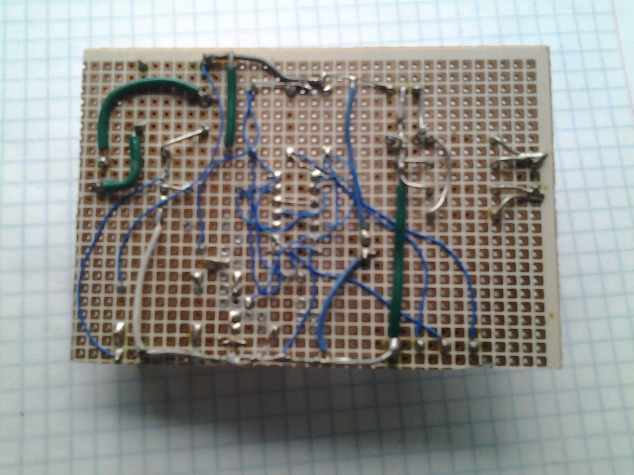

I like designing electronic gadgets as a hobby. However, any time I had to build one, I did it with general purpose prototyping boards using the point-to-point soldering technique.
I had never done any PCB before, so, I had to learn how to make my own. I learned from this instructable:
https://www.instructables.com/id/Turn-your-EAGLE-schematic-into-a-PCB/
Eagle files for this controller are included in this step. By the way, the PCB shown in this instructable is the first PCB I ever made.
When etching time came, I chose what looked to me as an environmentally friendly method, see:
https://www.instructables.com/id/Stop-using-Ferric-Chloride-etchant!--A-better-etc/
If building your own PCB or doing point to point soldering on prototyping boards is not your thing, you can click on the following link to buy this water level control as a kit from Jameco which includes everything you need except the transformer:

6 weeks ago
Hi, Thanks for this great ckt, it works fine. I have a problem, the RED led continiously glows (mild) even if the sump water is full. If the sump water goes low(scenario as per the last slide) the red led glows brighter. Let me know what needs to be done so the red led is completely Off..it should light up only the water goes low..
Regards..
Reply 4 weeks ago
Hi mpbraj!
How far apart are "pump level" and ground from each other? Have you tried testing at different distances?
What type of water are you using? Well water, tap water, distilled water, air conditioning condensate water?
Try placing a 500k potentiometer between "pump level" and ground. Have the pot's center pin wired to either one of the side pins. Turn pot so maximum resistance (500k) is shown across pot. Now, by trial and error you'll test dipping electrodes in water and observe red LED. If red LED still lightly lit, reduce resistance across pot, and try again. At some point during testing you should see the desired effect.
Let me know how it works. We'll figure out a way of it still doesn't work.
rlarios
Reply 4 days ago
Hi, I have kept inside a mug as of now and its a tap water..
As mentoned, have connected the 500k pot, I am getting desired result at pot resistance of somewhere around 103k..
Reply 2 days ago
Hi mpbraj,
You can use a 100K resistor instead of the pot (I assume you already did it).
Congratulations on a job well done. I hope you learned something. I did.
Let me know of any problems. I will try to help you out if anything comes up.
Thanks for your comments.
rlarios.
Reply 22 days ago
Reply 6 weeks ago
Hi mpbraj!
It seems the resistance of water between base of 2N3904 transistor and ground is higher than expected. Have you tried shorting pump protect and ground electrodes together? This alone should turn red LED off. Please do so and let me know what happens.
Thanks for your comments!
rlarios

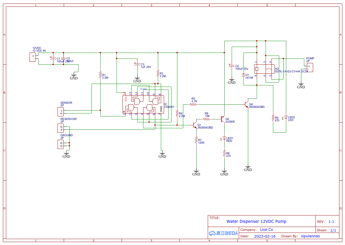

Question 4 months ago
hei i tried to make this but i failed, whenever ground make contact with one or all of probe, my pump still on high probe doesnt function, red led for pump level always on. can you help me
Answer 4 months ago
Show me the whole thing. Same ground goes to water tank and pump reservoir.. if red led is on that means pump won't start. If pump doesn't stop once high level electrode had been reached, how did pump start if red LED is on? Let me send you a private message.
Answer 4 months ago
Ok, I saw your schematics. Can you show me where 12V comes from?
Answer 4 months ago
