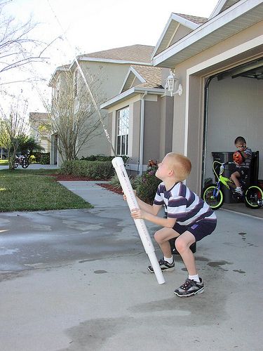

This is a followup to my Build a water mortar instructable. It shows some design alternatives tried this weekend.

I had some great feedback on the original instructable and wanted try out a suggestion by thinkahead for a different way to construct the piston. The suggestion was to get rid of the wooden plug at the upper end of the inner pipe, substituting a cap at the lower end instead. I also wanted to try filling the inner pipe with expandable foam. Here are the ingredients.
Step 2: Trying the End Cap
First thing I did was remove the wooden cap and put the end cap on the lower portion of the inner pipe. This worked pretty good. You do have to do a "priming" step initially where you suck water up, point the mortar at the sky, and push the air out, but then you're in good shape and things function pretty much the same as before. I like this better than the wooden plug overall.

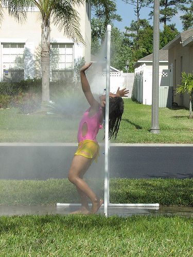

Since I was trying out a new inner pipe design, I thought I'd try a couple new outer pipe ideas as well. I made the outer pipe longer, to hold more water, and I added handles at the base, to help apply more pressure. Here's the new design compared with the original.
The handle is a 2" PVC cross, with a couple short 2" pieces. The cross is attached to the base of the outer pipe. The inner pipe runs through the cross and into the outer pipe.
Step 6: Trying It!
Mixed reviews on this design iteration...
It's impressive looking.
It's unwieldy for little guys, the original design is more practical for them.
The handles help, but getting maximum pressure on them while staying on target is a challenge.
I'm going to try shortening the outer pipe to bring the handles up higher and see if that makes it easier for an adult to control, maybe an under-the-arm thing...
