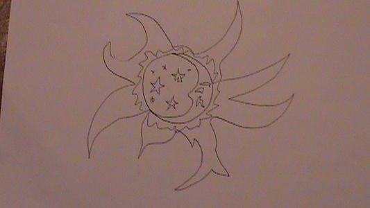

The first step of course is to decide what you want your Pinata to be. Here is the sketch of my Pinata this was for my wonderful wife's 30th birthday. This is a design that she drew on everything during her teenage years, she even has a tattoo of it.

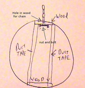

For the chain to hold the pinata up. Drill a hole just big enough for a chain to go through in a piece of wood the size of the top of your pinata. (My piece was 10" x 4" wide.) Then I inserted the chain. Where it came through on the opposite side I put a nut and bolt to keep it from pulling through. This was the top support, now to support the bottom I just ran duct tape down to another piece of wood at the bottom. Wrapped a few times until I thought it was strong enough to support the weight.
