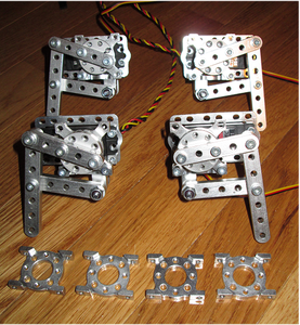

Step 4: Build 4 Leg Lifter Modules
Now we will complete the 4 "Lifter" Leg Modules as shown in the photo.
We will build 2 with right facing legs and 2 with left facing legs. I call the one shown a right facingLeg Lifter Module.
So, from the previous effort, gather 2 Left Handed Actuator Modules & 2 Right Handed Actuator Modules. ( The ones with the Beam Blocks A parts attached to the mounted Hub Plate.

Step 6: 4 Completed Leg Lifter Modules
Now you should have 4 completed Leg Lifter Modules !
Set these aside for now & go on to the next step.

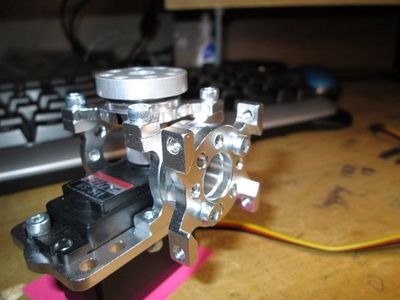

Step 7: Complete the 4 Leg Rotator Modules
Gather the remaining 4 Actuator Modules.
Go ahead and attach the unmounted Hub Plate to each.
Following along in this series of photos to build up the Leg Rotator Module.
Attach the .770 x .770 Hub Adaptor to the newly attached Hub Plate.
Now attach one 90° Quad Hub Mount B, making sure it is rotated 90 degrees to the Hub Plate.
Now attach one of the unmounted Hub Plates from one of the Leg Lifter Modules to the servo spline shaft.
Repeat the above steps for the remaining 3 Actuator Modules. Remember to add one of the unmounted Hub Plates from a Leg Lifter Module to each Leg Rotator Module, as shown in the Completed Assembly photo.

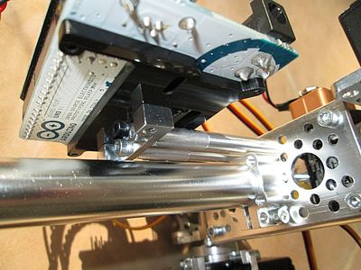

Step 12: Attach the Arduino Controller to the Robot
Gather these parts:
  • 2x __ length 6-32 pan head screws
  • 2x __ length 6-32 standoffs
  • 1x Arduino componentmounting bracket
  • 90° Dual Mount A
  • 2x 6-32 socket head screws
  • Almost Completed Robot from previous step
Attach the Arduino Component mount to the 90° Dual Mount A using the short flat head 6-32 screws, as shown.
Insert the long 6-32 socket head screws into the through holes of the 90° Dual Mount A.
Thread one of the shorter standoffs onto each long 6-32 socket head screw.
Thread one of the longer standoffs onto the remaining thread of each screw.
Next, secure the Arduino to the Arduino Component mounting bracket.
Insert the 6-32 pan head screws through the holes of the Rear Channel, as shown. Then thread each pan head screw into the longer standoffs attached to the Arduino component mount.
