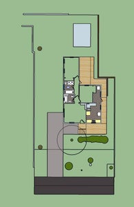

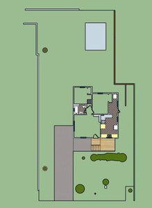

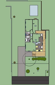

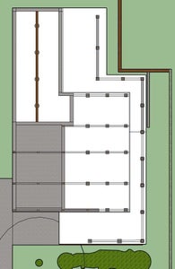

Step 1: Create a Plan and Get a Permit for Your Addition
One of the most important steps of a major building project on your house is making sure that you are legally allowed to build it. I built my addition under a subject to field inspection permit which meant I had to do a lot less paperwork than a fully documented/architect designed/engineer approved addition. Depending on where you live the rules for subject to field inspection permits and what you need to supply to get one approved and what you are allowed to build with this permit vary greatly. My house was in Seattle and the King County Construction and Inspection department publishes a bunch of tip sheets that help you through the process of getting a permit. I used the ones on getting a permit, subject to field inspection permits and site plan requirements the most. Reach out to your local building department and talk to them about what you are planning and get their guidance on it. Reading a bunch of house building books also helps! I thought these ones were quite useful: Renovation 5th Edition, Room Additions, Building Additions. If you don't want to try and design your own addition this would be a great time to hire and start working with an architect. If you are trying something really ambitious or working in a treacherous area you should probably get an architect/structural engineer to develop your addition plans.
I had to go into the permitting office I think like five times before my plans were finally approved. My house was a 660 sq ft two bedroom one bath house with the crappy addition when I bought it. I started by drawing up a floor plan in sketchup of the current layout and then modifying that until I got something that I was happy with and looked doable. I initially sketched out ending up with a three bedroom two bath house and it looked pretty good as a floor plan. I then modeled it is a rough 3D model to try and figure out how I was going to actually build it. I would have needed to tear off my entire roof and this would have meant relocating my main electrical drop and it not being able to be covered by a STFI permit so I ended up scrapping this idea and going with extending the roof line as close as I could to my shed and adding a bigger bedroom and bathroom on the same level. I had to add a bunch of details to my site plan and a bunch of figures showing how I was actually going to build this addition after talking to the permitting office and after adding in everything they wanted I got the approval to start working on my addition! This started with getting rid of the existing crappy addition I already had in my house...

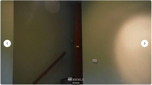

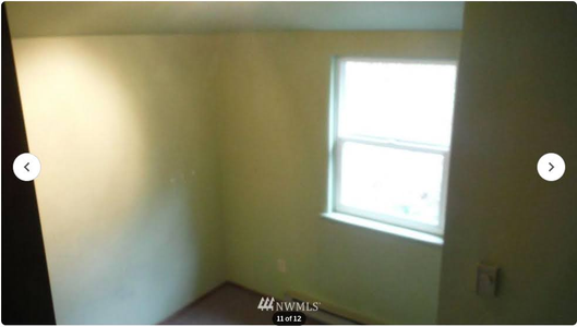

Step 2: Tear Out Your Crappy Old Addition
If you don't have a crappy addition built on your house already this step might just be tearing some siding off of your house but either way you need to get your existing house ready for your new addition. This is probably one of the more dangerous steps so make sure you are being careful and properly using your PPE. My buddy Matt (thanks again for the help Matt!) helped me with this step and we almost got stung by wasps that were hiding under my siding so watch out for critters that might be hiding. Also key is to either re-route or remove any live electrical wires that are in the area that you are working on. This might require a different permit from your local government so make sure to get that permit and do all your work to code!
It is hard to describe the feeling of taking a sawzall to the walls of your house and then pushing them over. It is very weirdly awesome and really highlights how insubstantial most modern houses are... But regardless of how awesome demolition is make sure to take it slow and start from the top, work your way down and try to salvage as much as possible from your demolition. Making sure that the pieces fit in your truck or trailer is also quite helpful. Once you have your crappy addition demolished it is time to start working on the foundation of your new addition!

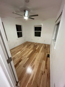

Step 10: Paint Everything and Install Flooring
Painting is one of my least favorite parts of any project and this was no exception. After I installed and caulked a bunch of window trim and then taped off anything that I didn't want to get covered in paint I used my paint sprayer to get everything painted pretty quickly! Make sure to wear a face shield and respirator for this step so you aren't breathing in any tiny drops of paint! I applied two coats and that seemed to be good enough for me.

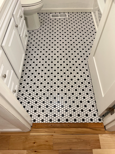

After your paint is nice and dry you can start installing your flooring! I went with hardwood hickory in my hallway and main bedroom of my addition and hexagonal tile sheets in the bathroom. At this point I think I also installed the tub and shower surround since I needed to tile up to the tub and needed to make sure that was installed before I started tiling. I rented a flooring nailer and used it to install the hardwood floor. To tile my bathroom I first laid down a layer of general purpose thinset compound, screwed down backer boards, taped and added compound to the seams, added down a layer of thinset troweled with the proper sized trowel for my tile and then laid down the sheets of the tile. I then waited for that to set up and came back through and applied a dark black grout to fill in the spaces between the tiles. There are a bunch of really good flooring tutorials on youtube so be sure to check them out and get a good set of kneepads since you will be on your knees a bunch while you install them. Once everything is painted and flooring is installed your addition really starts to look like a finished room and theres just a couple of things left to wrap up on it!
