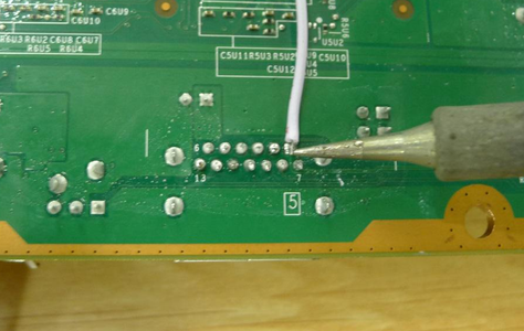

    Time to solder! Grab the USB/Audio breakout board and make USB connections to the motherboard with braided wires. Next solder thirteen 10-inch braided wires to the Ring of Lights pads on the motherboard; slip them out from underneath the heatsink and through the hole near the middle of the board and to the other side.
    Now its time for power connections. Locate the power port's solder pads and solder three pairs of braided wires such that each pair has one 12V signal and one GND signal in it - we'll be using these pairs to power the display driver board, the Xduino360 board and the fans in later steps. Pass these wires through the motherboard hole as well.
    Now locate the WiFi port's pads. Solder seven 12-inch braided wires - six to the small pads and seventh to either of the two larger ground pads.
    Next up locate the video port's pads. Solder 20-inch shielded wires to pads #15 and #16 - audio left & right signals - then solder their shielding-sheaths to either of the two large ground pads. Pass these wires through the motherboard hole. On to Step 3!

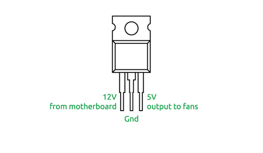

    Now the fans' power connections - snip off the fans' power connectors and prepare a 7805 regulator for soldering. Solder one of the remaining two 12V/GND wire-pairs and solder it to the regulator's input terminals. Solder the fan's red wires to the regulator's output pin and the black wires to the middle/ground pin, then cover all exposed metal/solder with heatshrink. Take off the hex nut tightening the lower-left motherboard standoff and insert the regulator there, then re-fastening the hex nut.
