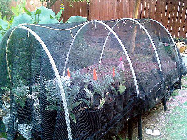

Step 2: PVC Pipe
Assemble the pipe on a dry surface in a well ventilated area, such as a patio or driveway, and cut 2 of the 10' sections of PVC pipe in half, making a total of 4 - 5' sections of pipe.
Step 3: Assemble With PVC Primer and Cement
Swipe the inside of the elbow pieces and the ends of the PVC pipe with the purple primer. Do not swipe the inside of the threaded elbows.
After the primer dries, attach the elbows to the ends of the two 5' section of pipe with the PVC cement.
Attach the 10' section of pipe to the unthreaded end of an elbow with PVC cement and press down firmly.
Step 4: Here's Your Basic Shape!
After the cement will dries within a few minutes, carefully bend the 10' section of pipe and attached to the other unthreaded end of the 5' section of pipe with cement. Leverage might be needed to bend the pipe, such as leaning up against a wall to prevent slipping while bending the pipe.
Repeat instructions for framing the other side of your greenhouse.

Step 6: Attaching the Plastic
Attach the plastic sheeting to the frame with zip ties starting with the straight edge. Be sure to tuck plastic around the pipe. Slice small holes through plastic close to the frame. I poked a few of my holes too far from the frame structure, but it still looks just fine. Pull ties tight and trim tails. Repeat all the way around the frame.
Step 7: Connecting the PVC
Screw in threaded adapters to threaded elbow end. Attach the remaining 5 foot sections of pipe to the adapters to complete the frame. If you want a temporary structure, do not glue the bottom of your greenhouse pipe together. However, you will need duct tape or cement blocks to brace the base of your greenhouse. If you are using it out in the yard, you can also anchor it down with camping tent spikes.
