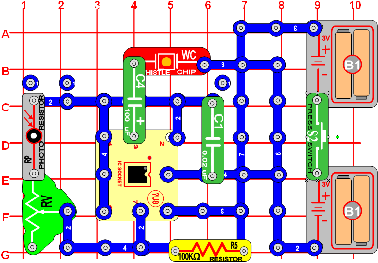

Step 3:
Build the circuit shown. If you want to design your own Snap Circuits diagrams go to http://www.snapcircuits.net/learning_center/designer
The photographs show the steps to build the circuit.
Once you build the circuit, push the Press Switch (S2). You will hear a tone from the Whistle Chip. Move the slider on the Variable Resistor (RV) and you will hear the tone rise and lower in pitch depending on which way you move the slider. Next move your hand so that it casts a shadow on the Photosensitive Resistor (RP) and listen to the pitch as it changes.
The last picture is an optional part of the build. Connect the alligator clips from the Snap Circuits Computer Interface Cable to the snaps on either side of the whistle chip as shown. The other end of the cable is an 1/8" jack that you would usually connect to the microphone input on your computer. Instead, connect the 1/8" jack to the 1/8" to 1/4" adapter so that you can connect it to your amplifier, or the microphone input of your karaoke machine, etc. In the video mine was connected to my mixing desk--I had a guitar stomp box set to reverb plugged into the auxilliary input and the mixing desk was plugged into my amplifier.
Step 4: 555 Timer Astable Mode
Let's see if we can make sense of what is happening. The 555 chip is in astable mode which means that Pin 3 is sending a continuous stream of pulses called a square wave signal to the speaker that you hear as a tone. The square wave signal is caused by the charging and discharging of the 0.02uf capacitor C1.
When you switch on the power at the Slide Switch S1:
Step 1. The 0.02uf capacitor C1 charges up.
Step 2. When the charge in the capacitor reaches 2/3 Voltage, this is detected by pin 6, the Threshold pin.
Step 3. The Threshold pin 6 switches off the Output pin 3.
Step 4. The Threshold pin 6 switches off pin 7, the Discharge pin.
Step 5. When the Discharge pin 7 is switched off this cuts the power to the 0.02uf capacitor which causes it to discharge.
Step 6. When the discharging capacitor reaches 1/3 Vcc, this is detected by the Trigger pin 2.
Step 7. The Trigger pin 2 sends 6 volts to pin 3 the Output pin.
Step 8. The Trigger pin 2 sends 6 volts to pin 7 the dischrage pin which causes the 0.02uf capacitor to charge up.
Step 9. Go back to Step 1.
This process repeats creating the square wave signal (see picture) and you hear that signal from the speaker as a tone.
When you move the slider on the Variable Resistor (RV) this changes the resistance of the circuit. Since the Variable resistor is connected to pin 7, changing the resistance controls the timing of how often the 0.02uf capacitor (C1) charges and discharges. Since the photoresistor (RP) is connected to pin 7 as well, the amount of light that falls on the photoresistor changes the resistance too, and this also controls the timing of how often the capcitor (C1) charges and discharges. You'll notice when more light that falls on the photoresistor this makes the pitch higher. Less light makes the pitch lower.
