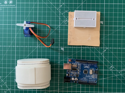

This is a poor man's watch winder. I love my automatic Junghans watch very much but being retired now, I don't wear it every day. Watch lovers usually buy expensive watch winders to keep the timepiece winded and ready all the time. This is overdone for someone who has just one, so I build one quickly using a standard servo and an Arduino as main components.
This device uses really simple components. You will need
  1. An Arduino UNO or any other Arduino IDE compatible MCU
  2. A standard servo.
  3. A few pieces of plywood
  4. A watch holder maybe from a watch box. Alternatively and piece of wood of the right shape.
  5. A frame, I use a small easel that one can buy in gift shops.

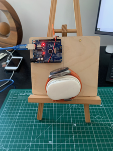

Step 1: Build the Mechanics
Servos usually come with a few different arms. I use the longest one in the servo kit and screw it to the watch holder. The servo is mounted in a hole of the plywood board just big enough to hold it and fixed with two screws. Then the plywood board is screwed to the easel.
Connect the brown line of the servo to ground, the red line to 5V and the orange line to GPIO pin 4 of the Arduino.
I choose to mount the Arduino at the front of the board but that is a matter of taste.

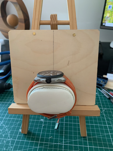

and after this type RUN on the command line.
The watch winder will start to move in small steps. From one side to the other and then reverse.
