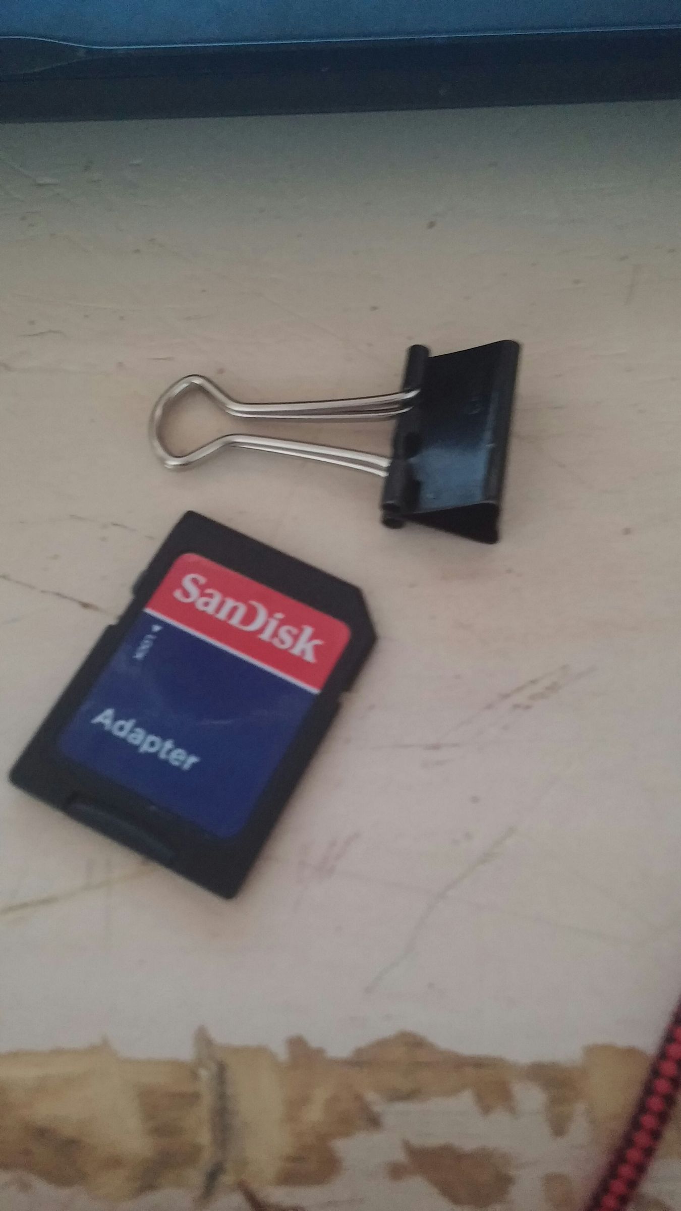

First things first, you need to prepare a MicroSD card to use in your PI. Rather than set the whole thing up by yourself, the nice folks at RetroPie have a nice image configured for us. Download the stable 2.6 ( or stable at the time of reading this) from petrockblog and put in on MicroSD card using win32 disk imager
(If you are using mac or Linux, Google how to set up the sd card)
Then plug an old usb drive into the pi after you have put the image on, power it on and wait 30 sec, then power off the pi and plug your usb into the main computer your are using. You should see a new folder full of other folders on your drive. Put your roms ( game files ) there. I recommend getting your roms from LoveRoms or Romhustler
just Google them.
Plug that usb drive into the pi and just leave it there, you don't need to do anything else.

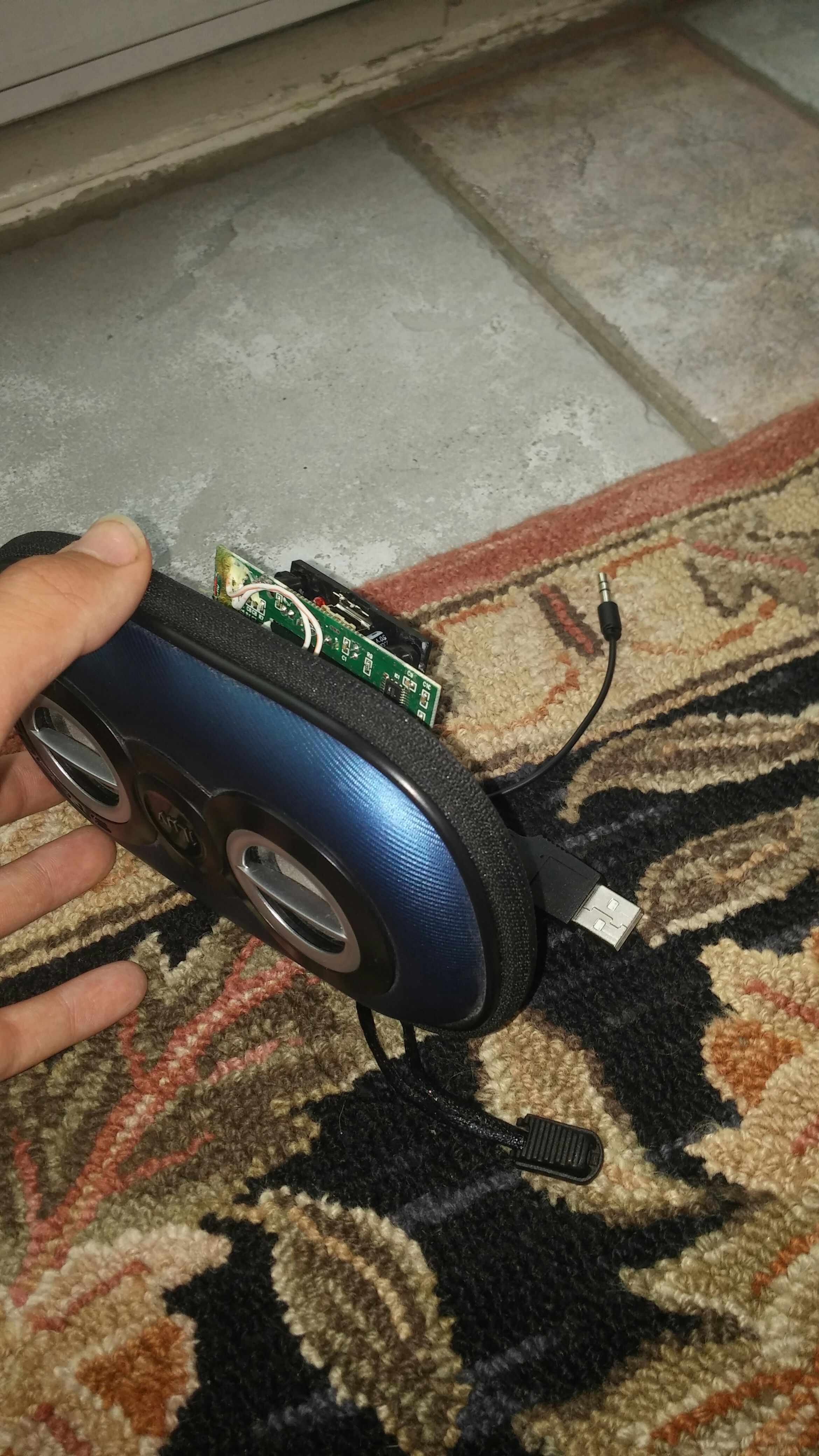

Mount the pieces in! I used hot glue to stick everything in place because it's a good insulator and won't damage any of the components. I didn't want to cut down and re solder any of the cords so I used zip ties to bundle them all up so I could limit space. My speaker cords were pretty short so I had to put the PI near the speaker.
