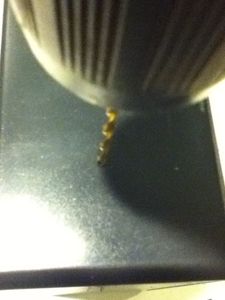

Take the large project box and your 12mm drill bit, and drill a hole anywhere in the box.(you can put the components anywhere, you are not restricted to my design) this will be for the switch. Now take the smaller drill bit and drill a hole about an inch from the 12mm hole,but make sure you can run your wires through the hole, so widen it if necessary. Now with the same bit, drill a hole about 1 inch from what will be the bottom of your case. This will be for the in-line solder dispenser. Now, drill a hole in the small project case slightly smaller than 12mm. This is for the light bulb socket. Use your small bit to drill a hole opposite from the large hole just big enough for the wires.
