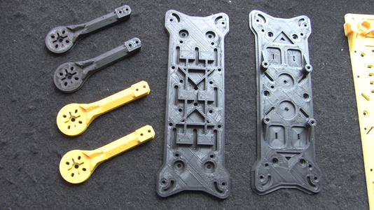

Since the copter itself is very small it does not use very much filament. I printed the entire frame in about 2 days. A couple of the frame plates are very large however and I had to print at least one of them diagonally on my Ultimaker 2 in order for it to fit. There are also a lot of additional or remixed parts on thingiverse to suit different people's needs.

Step 2: Printing the Parts
You can get the parts on the MHQ2 thingiverse page.
  • If you do not yet own a 3D printer (I'm sure you want one by now!) you can get the parts made by someone in your area using 3dhubs.com. When that person inevitably wants to build one of these copters too you can point them to this instructable. :)
  • Most of the parts are very thin and do not use a lot of filament.
  • I printed all my parts in ABS in .2mm layers. ABS allows the parts to bend a bit without snapping. ABS can also handle higher temperatures than PLA so it shouldn't warp in the sun, which is important in this application.
  • I printed 2 of the motor mounts and the front landing gear in green to help identify the front of the copter. I also printed the large plate of the "clean section" in the same green to give it some color.
  • The motor mounts and landing gear should be printed with 100% fill so they're strong. All these parts are so thin there's not much room for infill anyway so you're not saving much plastic or weight.
  • At the speeds I was printing it took me about 2 days to finish all the parts.
  • If you want to run 6" props you can use the extended arms instead of the standard ones
  • There are also lots of other remixed or accessory parts for this copter on thingiverse if you search for MHQ2.
After you get all the parts printed you will need to clean them up. If you printed in ABS you may have brim material to remove from all the holes in the plates. An x-acto knife makes quick work of this.
