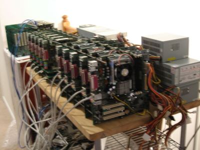

Step 1: What Components Did I Use?
After a power supply failed on the computer I was using to run seven hard drives I decided to limit hard drives per computer to four per computer. To do this I needed to crank up some much older computers and add them to the network. In addition I decided to add a new but inexpensive system to take some of the hard drive load

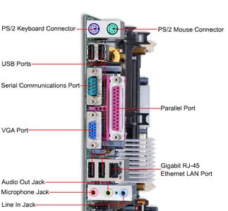

To keep costs down I recruited an old case and bought a new Intel D525 motherboard with an embedded processor and a total of four logic units and added 4GB laptop memory. Total cost for this repair and addition including the new power supplies was around $250.
Now the network has six computers and seventeen hard drives. Since I only need one hard drive per computer I will not need to buy hard drives for some time.All that is really needed to boot the D525 and handle the data and programming is a flash drive.

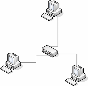

I started with a standard Ethernet configuration consisting of network peers using four PC's that were already running under some version of Microsoft Windows and were connected using a four port wireless Westell Ultraline Series 3 Model 9200EM router that came with my Verizon FIOS installation. This particular router allowed one of the cables to be made from one hundred feet of four copper conductor telephone line which ran past CRT monitors, fans and florescent lights and up and down walls without any detectable interference, data loss of slow down.
The oldest PC in the network is an Intel D865GLC board that lost its on-board audio after lightning hit my amplifier. I still use it on occasion for word processing, email, and exploring the web while my other computers are busy. I set it up to monitor security cameras right after I lost the audio instead of throwing it away. I also decided to use it explore oil immersion cooling which completely eliminated system noise but made replacing components a pain. Although I could upgrade it to 2GB I decided not remove it from the oil bath but to leave it at 1.5GB. It runs Windows XP32
The next oldest system has an Asus A8V-X motherboard I purchased to replace a far better Foxconn board that also got zapped through the audio port but unlike the other board did not survive to tell the story. I bought the A8V-X to keep the AMD X2 4400 CPU I paid $450 new when they first came out. The A8V-X is far inferior to the Foxconn but it allowed me to keep the X2 processor in service. ...to think I could have 2 Intel i7's now for the same price no longer erks me but it did for awhile. Memory is maxed out at 4GB of 200MHz (DDR400) PC3200. It also runs Windows XP32.
The next is a BioStar G31D-M7 and a dual core Intel P6 CPU running at 2.7MHz with 4GB of Adata DDR2-800 (PC-2 6400). I will have to replace this system soon as it has a tendency to lock up and turn off when several programs run at the same time and may exceed CPU or memory capacity or just not be designed to handle it on the board. It runs Windows XP64 which may actually be the problem.
The forth computer is an Acer A0751h netbook which has an Atom Z520 CPU running at 1.33GHz and 2GB internal memory. It has a 260GB hard drive and a 11.6 screen but I got it at a discount because it came with Vista. Vista Home Basic presents a number of hardware and software bottlenecks and challenges but once persuaded to grant access and to run applications programs it is as fast as the desktops. I use if as the client and any processing I share over the whole network gets done in better than one forth the time since the servers only process things that can be run at the same time like counting each occurrence of a first name in an array that would otherwise exceed available memory or time or the maximum value of a long integer variable type (2,147,483,647).
If your setup is close to this one then you can use it to develop a Beowulf network. Although you can use older and slower computers running under 1.0 GHz its probably a good idea to adjust the workload accordingly. I tried using an old laptop that runs at 300 MHz and has a 5.5 gig hard drive but eventually had to limit it to only 5 locations or nodes for the whole computer.

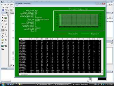

I was running my version of the optimal classification program described here on a single PC. The program ran into a limit when I tried to optimize a database with 265 elements, 39 states and 42 characteristics or a group size of 6.67903155 × 10^66. The target size was a whopping 3.5 billion after reaching just 6 characteristics and attaining 99.97% separation. Achieving 100% separation was outside any possibility of completion within a reasonable length of time or within the memory capacity of a single PC. I needed a way to increase speed and memory without spending an arm and a leg.
Enter the Beowulf network solution...
In the optimal classification process there is a need to count duplicates in each multiset. For problems like the one I was trying to solve the multiset size what outrageous. Part of one multiset that had to be counted is shown below…
Because the segment size can also be much larger than the portion shown below a double precision variable index type is usually required in addition to the array being double precision type as well. Incrementing the array index then is what takes so much time while the array itself is responsible for the need to maximize memory.. .
By dividing the task into smaller segments and assigning each segment to locations or nodes on other computes the faster the process of comparison and duplicate counting can be.
A portion of one segment of values to be compared and duplicates counted is shown below. .

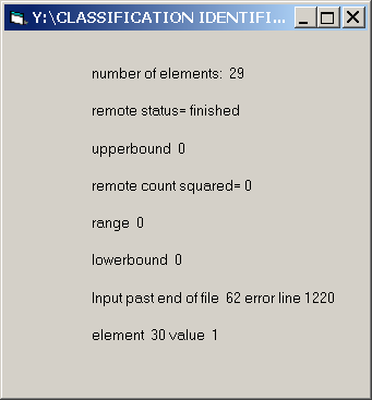

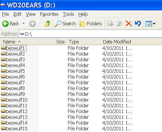

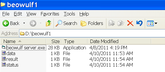

Step 3: Programming the Network

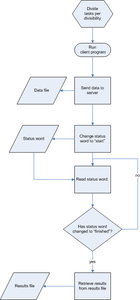

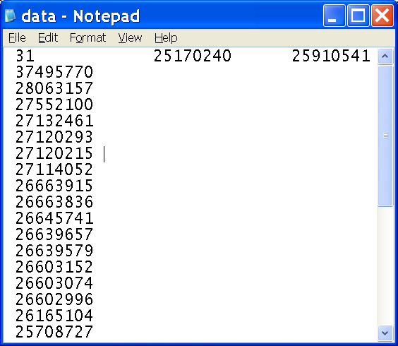

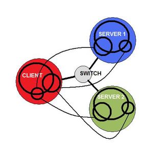

After communication was established between client and servers through the network the client program interacted with the programs running on the servers at each location or node by updating the contents of status and data files while the server programs updated the status and the result files.
A very interesting aspect of this method is that programs and files can be duplicated and placed in additional folders on each server to be run almost in parallel by the operating allocating slices of available time to each one.
By allowing the operating system to control execution the results can usually follow so closely behind the incoming data a general flow develops between the client and the servers that can also be improved by adding higher speed Ethernet to facilitate higher rate of data transfer
This setup greatly improves execution speed and memory allocation, especially in multi-core, multi-processor and multi-disk environments using only standard Ethernet, old computers and outdated operating systems and application programs. .

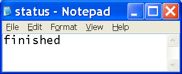

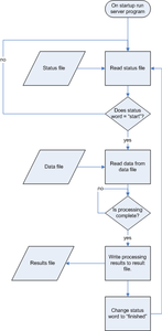

The Windows task scheduler starts the server programs whenever the servers are rebooted. Once running the first task is to monitor their data status file. When a server program, for instance finds the word "start" in the status file it drops out of the monitoring phase and starts processing data found in the data file previously sent there by the client.
When the server is done processing the data it changes the word in the status file to "finished" and returns to monitoring the status file until the client updates it with the word "start."
The client also monitors the status file and retrieves the results when the status word is changed to "finished."
