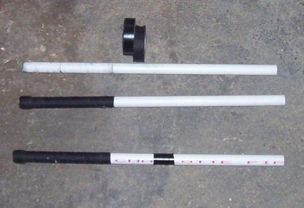

Step 2: Measure and Cute Pipe
I decided to go with a 20 inch club based on that many professional juggler clubs range from about 19-20.75 inches. With the 10 ft. pipe you should be able to cut 6 equal length pieces, unless you are like me and the last one will come up a little short. After making these I would recommend cutting them to 19 3/4 in. segments as my final product ended up coming out to 20 1/4 in length, that way you will also be guaranteed to have enough for 6 equal pieces unlike my 5 20 pieces and 1 that is a quarter inch shorter.
You can try different Lengths if you like but keep in mind to get the exact desired length you will probably need the segments to be cut to 1/4 in. shorter.

Start by sealing up the handle end of the club. I did this using 4 piece of electrical tape that is cut at approximately 2 inches. Make an asterix shape with the tape similar to the exaggerated one in my picture.
For the handle I made it 1/3 the length of the overall club or approx. 7. I used black Friction tape similar to what would be on a hockey stick to wrap around the previously taped end and then worked my way up. I then taped a few times around just at the very end to give it a slight knob. You may think this type of tape is too harsh, feel free to use something else to your liking or even just the bare pipe, but be sure to add the knob at the bottom as this will help hold the 4 other pieces on better.

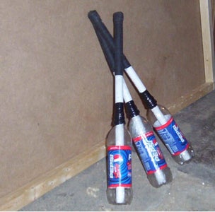

Next place the bottle on the end(with a 1/2 in. pipe it should just barely fit) and mark where it comes to. Put some tape starting where your mark is and work about 1 in. up 2-3 times around with the electrical tape should do. This step is probably not necessary I just figured it would create a better seal.
Put your bottle on and when you get to the tape you will have to force it and twist it all the way till the pipe is to the bottom of the bottle. Make sure you twist with the tape so that the bottle is not just peeling it off as you twist.
Now start from about an inch or a half inch below the bottle and wrap around the neck of the bottle all the way up just past the threads for the cap and then back down again.

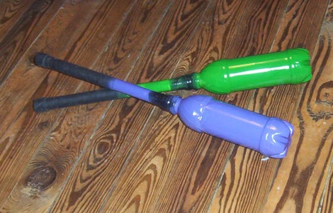

Now you should have some nice clubs to practice juggling with. However if you do not like the look of them, and I didn't get inspired to do this until writing this, but you can now paint them.
I more or less was just looking for an excuse to paint the snow. Not Sure how durable the paint will be, so you may want to add several layers and follow up with a clear coat. It also may be best to paint the pieces before assembly so that yours look better than mine do. Also if you plan on painting make sure to remove the plastic wrap around label from the bottle.
The green one makes me thirsty for some Dew.
