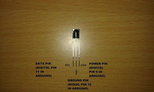

Now take the IR receiver shown in above image (THIS IR RECEIVER IS FOR ONLY THIS STEP ALONE NOT FOR PROJECT)
- CONNECT THE IR RECEIVER GND TO ARDUINO PIN 10
- CONNECT THE IR RECEIVER Vs TO ARDUINO PIN 9
- CONNECT THE IR RECEIVER OUT TO ARDUINO DIGITAL PIN 11

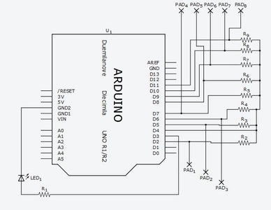

Step 2: Circuit Diagram
In circuit diagram(image 1) connect
LED 1 is IR LED.
Resistor R1 is 100 ohm.
Resistor R2,R3,R4,R5,R6,R7,R8,R9 is 100K ohm.

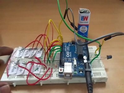

Before using the touch papers sketch the paper pieces with pencil (very darkly).
then connect the paper pieces to the circuit as shown in second diagram.
in circuit diagram
PAD 1 is channel decrease paper piece
PAD 2 is channel increase paper piece
PAD 3 is TV menu control paper piece
PAD 4 is ok button paper piece
PAD 5 is TV power (ON/OFF)control paper piece
PAD 6 is volume increase paper piece
PAD 7 is TV input source selection paper piece
PAD 8 is volume decrease paper piece
